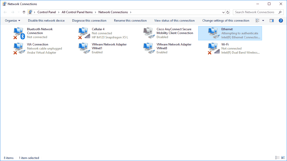

    I came across an issue on my Windows 10 Enterprise Build 1803 with Cellular/Ethernet connections.
    I have a HP lt4120 Snapdragon X5 LTE installed in my notebook.
    I purchased it with the intent to work on the road and to leverage it for ICS.
    When I am connected with the LTE modem and plug in a cable to my Ethernet port (Intel I219-LM) it automatically disables my Cellular connection ("Not Connected).
    Active Ethernet connection disables Cellular Modem a4327df8-fd0f-4af4-81f0-47fc83acc1b8?upload=true.png
    So far I have not found a way to keep both interfaces connected at the same time, for me to configure ICS. How can I get rid of this behavior?

  3. Data trough 4G mobile broadband connection blocked when ethernet connected
    Hi Robert,
    It appears that Windows is managing your connection. It only allows you to connect to your mobile broadband connection if you're not connected to either Wi-Fi or Ethernet connection. To work around this behavior, I suggest disabling this feature to allow
    you to manually connect to your cellular or mobile connection. Please follow these steps:
    1. Navigate to Settings > Network & Internet > Cellular.
    2. Uncheck the box for Let Windows manage this connection.
    3. Once done, try connecting manually to your mobile broadband while Ethernet is connected and see if it works.
    For more information about mobile broadband connection, please check out,
    Cellular settings in Windows 10
    Please update this thread with the result so I'll be able to assist you further if needed.
    Regards.
    Vanessa Yar, Oct 11, 2018
