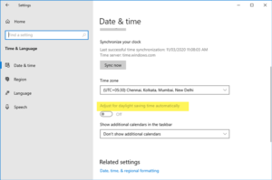

Windows 10: Adjust for daylight saving time automatically is grayed out in Windows 10
Discus and support Adjust for daylight saving time automatically is grayed out in Windows 10 in Windows 10 News to solve the problem; [ATTACH]If you live in the USA or some other countries where Daylight Saving Time is available, but find that the setting is not working on […] This... Discussion in 'Windows 10 News' started by WinClub, Mar 21, 2020.
  1. WinClub New Member
  2. "Adjust for daylight saving time automatically" option grayed out
    I live in Texas and we use Central Standard Time (CST) but the option to use daylight savings time is grayed out.. any suggestions?
    ChaseBranson, Mar 21, 2020
  3. Windows 10 automatic daylight savings adjustment not working?
    In general, "Adjust for daylight saving time automatically" should always be On. Turning it off is for a few legacy edge cases and a couple of places in the world that don't currently have an appropriate entry in the list of time zones.
    Most likely, the system clock isn't set to the correct time. Perhaps there's a problem getting the correct time from the Internet, which is enabled or disabled from the first "Set time automatically" option.
    I recommend:
    1. Check that your Internet Time Server settings are correct. Try a different time server if necessary.
    2. Turn on all options, being sure to turn on "Adjust for daylight saving time automatically" before turning on "Set time zone automatically".
    Matt Johnson, Mar 21, 2020
  4. Adjust for daylight saving time automatically is grayed out in Windows 10
    Windows 10 Daylight Savings Time Not Working
    I've tried doing this (Windows 10: Daylight Saving Time Adjustment not working)
    several times on three different machines (they're all having the same problem), but it doesn't work.
    Here's what I do:
    - Go into Date & Time - see both "auto adjust" and "set daylight savings" is off
    - EITHER set daylight savings time to adjust, or auto adjust, and see that it is set
    - If I do auto adjust time, it resets "set daylight savings time" to be off
    - If I leave auto adjust off, but daylight savings to on, then click away, and click back, daylight savings is still off
    My machine is fully updated, Windows 10, and I'm in PDT.
    Suggestions?
    IronYuppie, Mar 21, 2020
