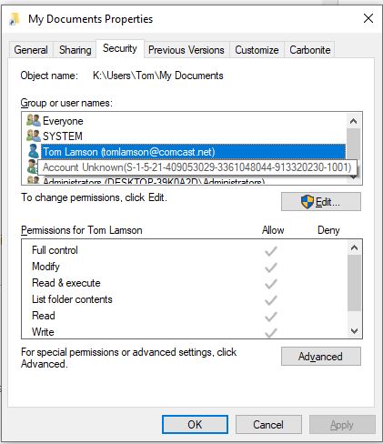

    After my computer died I removed the C drive and installed it my new computer which already had a C drive as K drive
    - I mainly wanted to access data files that were stored on that computer since the new computer had Windows 10 installed.

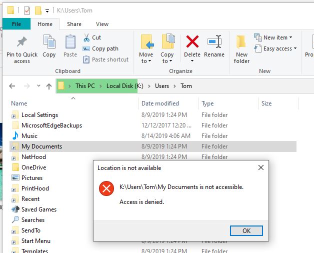

    Today I tried to access K:\Users\Tom\My Documents and got this BTW I am Tom
    Location is not available
    K:\Users\Tom\My Documents is not accessible
    Access is denied
    advanced security settings owner account unknown 6251a50c-5cf9-4676-bc53-be1fd66a156d?upload=true.jpg
    I did right-click Properties Security and it looks like the owner is Account Unknown probably me when it was C drive on the old computer
    advanced security settings owner account unknown f5dd4377-452e-46aa-b9f7-747081dbd7c4?upload=true.jpg
    There are many directories like this although many that open without a problem.
    The funny part is that I have grayed out check marks indicating that I have full control.
    - I assume that they are grayed out because "I" am not the owner.

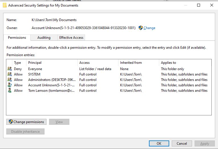

    I have tried the following:
    Advanced security settings I clicked on Owner Change
    advanced security settings owner account unknown f5e47af3-3514-457c-b933-f763f0760b11?upload=true.jpg
    and that leads to this
    advanced security settings owner account unknown 0d303817-9b14-45ac-b05c-6a118a753ad0?upload=true.jpg
    I Clicked OK but got the same Access denied.
    How do I fix this?
    Is there a way to fix it for the entire drive or do I need to do it directory by directory?
    Thanks in advance for any advice.
