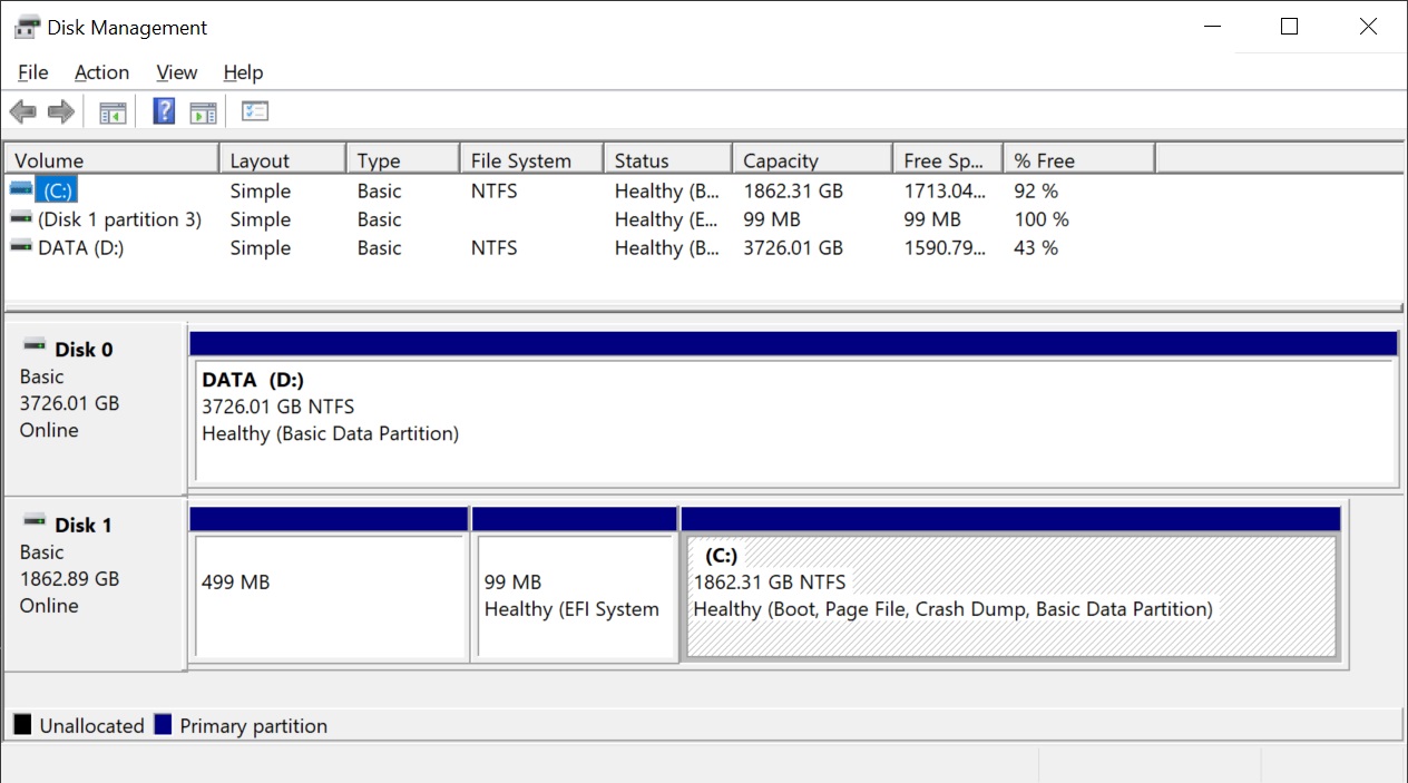

    I cloned an existing C: drive SSD to a larger SSD Crucial 500GB NVMe to Crucial 2TB NVMe using the Acronis Disk Clone software that came with the new SSD.
    Seems to have worked, Windows boots, etc. However, the partition on the cloned drive that used to be labeled "Recovery" now has no name and is not labeled "healthy." And it's now not listed as one of the partitions in the initial list please see second image below.
    Would anyone have an idea why this partition is now unlabeled? Any recommendation to delete it and recreate it from the backed up files?
    I have read one article that said if the contents of the original Recovery partition were copied, the files would be removed from the partition at the end of the backup. Could this have happened, that the partition was left, but empty?
    And would anyone know how to "test" the new, unlabeled, partition to see if it is actually fine and "healthy" or if it contains any files?
    I do have a copy of the contents of the original Recovery folder made before the cloning. Should I try and delete this partition and then create a new Recovery partition from the backup?
    Thanks for your help,
    Ian J.

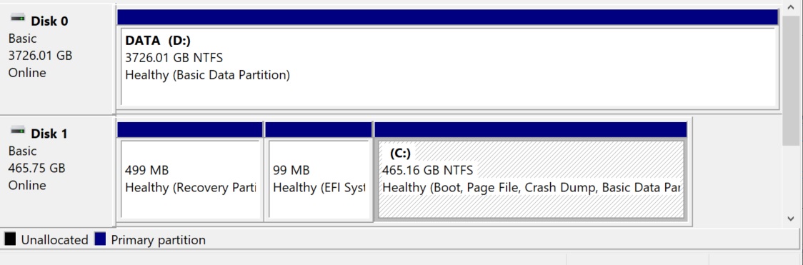

    This is the layout from Disk Manager on the original C: SSD:
    After cloning, Recovery partition isn't labeled as such or labeled as "healthy" cd04d26a-4d74-42b9-9683-f21ca293f9b1?upload=true.jpg
    And this is the layout of the cloned SSD, showing the unlabeled but same-size Recovery partition:
    After cloning, Recovery partition isn't labeled as such or labeled as "healthy" a9032abc-53a4-4524-acd4-9c4464042130?upload=true.jpg

  2. D rives shows empty, but labelled as data, is it the recovery partition?
    As per your description, I understand that the recovery drive took 500gb from the hard drive. We will assist you to resolve the issue.
    Ideally the recovery drive comes with label Recovery and uses up to a maximum couple of GB. I think this drive had labeled Data, for storing usual files.
    For the better understanding of the issue, I suggest you to provide a screenshot of the disk management.
