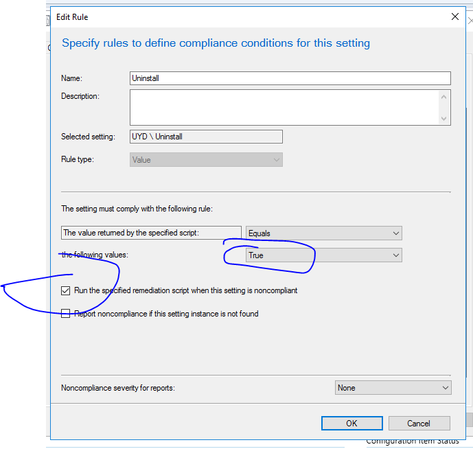

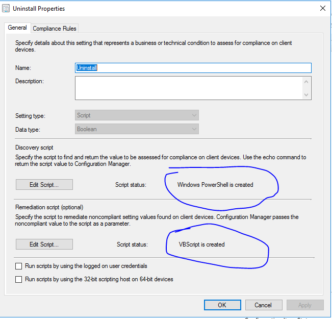

    MECM/SCCM Compliance Settings create Configuration Items and Configuration Baselines via Script(PowerShell and/or VB Script )
    Server Version: MECM 2107
    Client Version: Windows 10 2004
    Target :Uninstall Apps via compliance Settings MECM/SCCM
    Challenge: the app called YouDao Dictionary(Chinese to English Dictionary) which installed for per user instead of local machine (like MS TEAMS)
    Solutions:
    After Imaging PCs with 22h2 via MECM/SCCM the OS gets stuck on "Oops, You've Lost Internet... 43edec9d-8b26-4980-a59a-8547cf0e45bb?upload=true.png
    After Imaging PCs with 22h2 via MECM/SCCM the OS gets stuck on "Oops, You've Lost Internet... 69ba03b2-ef2b-4b96-bbbb-2ebc4d8e1dfe?upload=true.png
    I am using PowerShell as Discovery script
    if((test-path "HKCU:\SOFTWARE\Youdao\Dict") -eq $true)
    {Write-Output $true
    else
    Write-Output $false
    VBScript as remediation
    Set x=createobject("wscript.shell")
    x.run "C:\Users\%USERNAME%\AppData\Local\Youdao\Dict\Application\uninst.exe"
    wscript.sleep 1000
    x.sendkeys "{enter}"
    wscript.sleep 1000
    Wscript.sleep 3000
    Wscript.sleep 1000
    Wscript.sleep 1000
    Because it's installed for per user installed of local machine we should use %USERNAME%
    When uninstalling it the popup windows showing next, next, next so we can send enter key via VBScript to finish all steps for us
    After Imaging PCs with 22h2 via MECM/SCCM the OS gets stuck on "Oops, You've Lost Internet... cb5517e5-3ad9-493f-bc2c-f86e9c2bd91a?upload=true.png

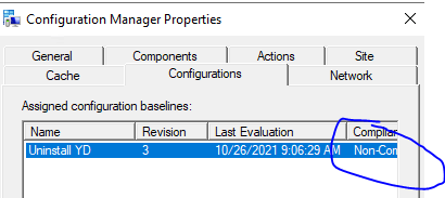

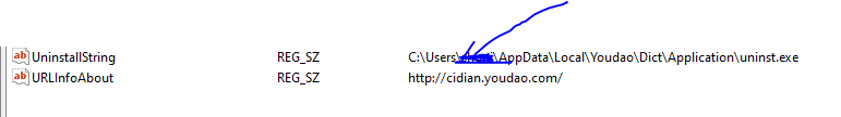

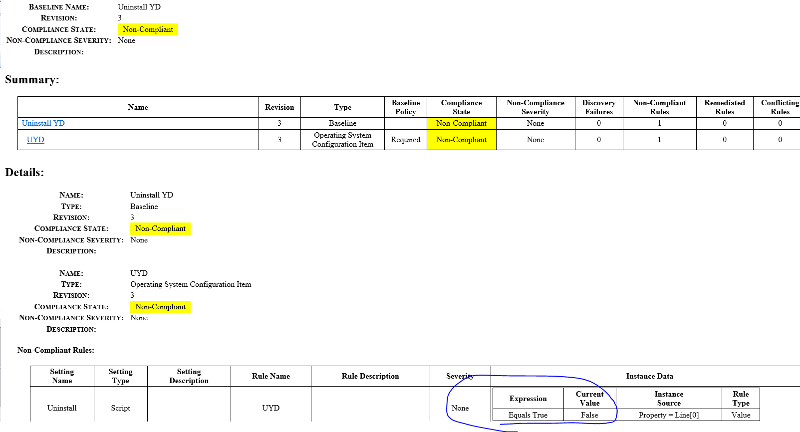

    If we find the path(Youdao\Dict) that means Youdao Dictionary has been installed so we should uninstall it via MECM/SCCM I also found YouDao has Uninstall String but we can uninstall it silently(haven't /s /q parameter ) so I try to using VBScript to send Enter key for zero touch uninstallation(Required Admin privilege or it will popup UAC)
    Problem: I tested all script and worked locally but when I executed it MECM/SCCM I can't uninstall it as expected
    After Imaging PCs with 22h2 via MECM/SCCM the OS gets stuck on "Oops, You've Lost Internet... 6a8ffe48-8df4-47cc-8b94-be2830f51c26?upload=true.png
    After Imaging PCs with 22h2 via MECM/SCCM the OS gets stuck on "Oops, You've Lost Internet... 5a790ccf-5a51-4ae8-8646-0053728639f8?upload=true.png
    Question:
    1.Can we using PowerShell as Discovery script and VBScript for remediation? (Or it must be PowerShell and PowerShell or VBScript and VBScript)
    2. How Can I execute PowerShell if included %USERNAME%? I also tried Cscript.exe to execute VBScript via PowerShell
    3.Any logs I can check from Server side or Client for Compliance Settings?
    4.Any alternative method to achieve my goal?
    Thanks you in advance!
