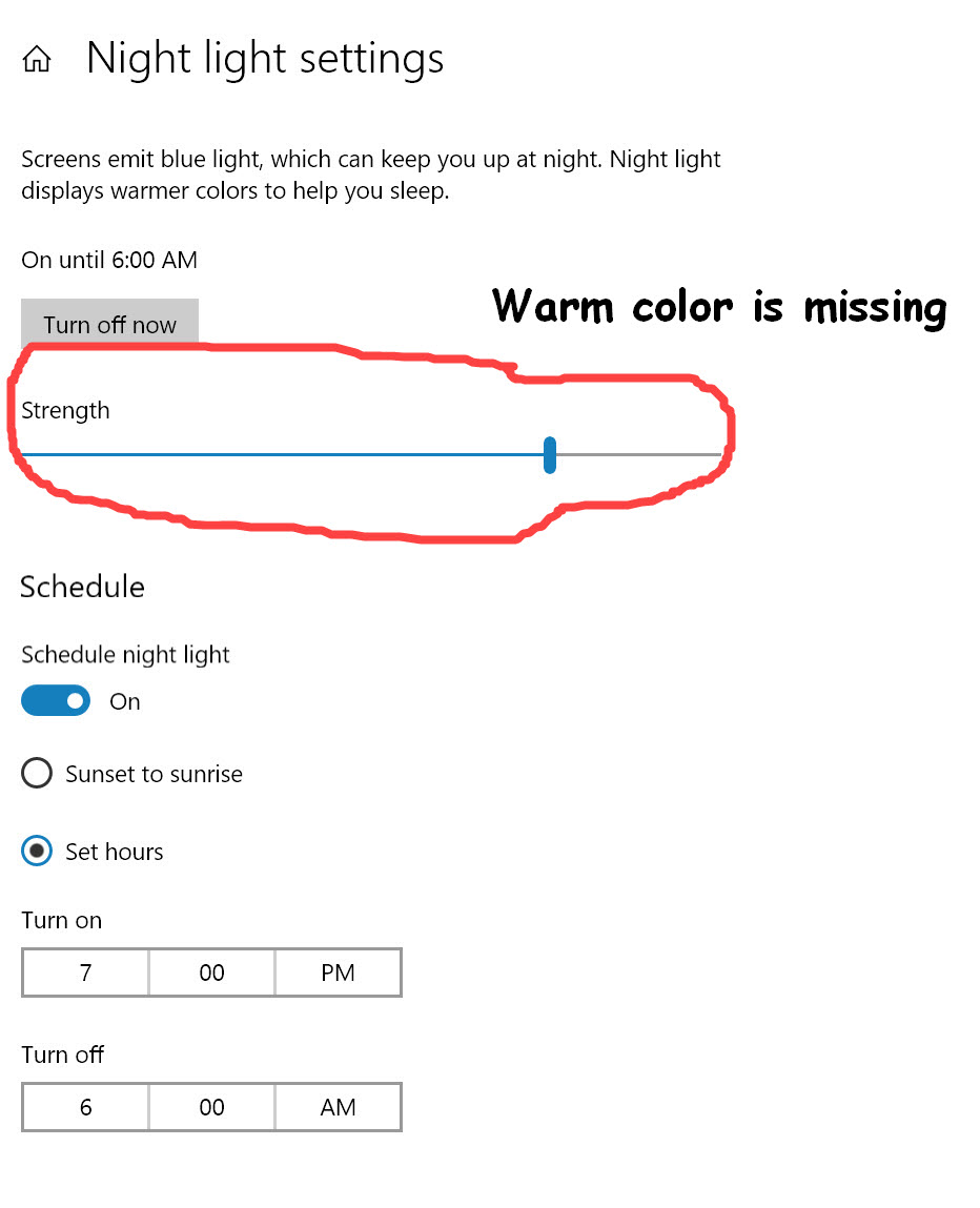

  1. After updated 1903, Night Light is on and working but the system wont let it.
    I love Night Light and had no problem with it before updated 1903 on my Windows 10 Laptop. After updated, I noticed that my Night Light won't work anymore even though the set up was already on, was not touched and noticed the warm colors is missing. Anyway, when I restart, it came back but not for long. When I shut down and the next morning, I turned it on and was working on something until 9 pm and realize that my system did not turn on my Night Light even though it was on unless I have to restart. I do not want to restart. Please help me. By the way, I am not an expert with Windows 10, I am just average knowledge about windows, not intermediate.
    Thanks,
    Susan
    After updated 1903, Night Light is on and working but the system wont let it. 7a6a3238-71d0-4a5a-ab2f-e085374c2ad0?upload=true.jpg
    SusanGrayson, Jun 11, 2019
  2. Martmcd Win User
    1903 version night light not working
    Hi Monika,
    it is a known issue in 1903
    Night light settings do not apply in some cases
    Microsoft has identified some scenarios where night light settings may stop working, for example:
    Connecting to (or disconnecting from) an external monitor, dock, or projector
    Rotating the screen
    Updating display drivers or making other display mode changes
    Affected platforms:
    Client: Windows 10, version 1903
    Workaround: If you find that your night light settings have stopped working, try turning the night light on and off, or restart your computer.
    Note We recommend that you do not attempt to manually update using the Update now button or the Media Creation Tool until this issue has been resolved.
    Next steps: We are working on a resolution and will provide an update in an upcoming release.
    https://docs.microsoft.com/en-us/windows/releas...
    Martmcd, Jun 11, 2019
