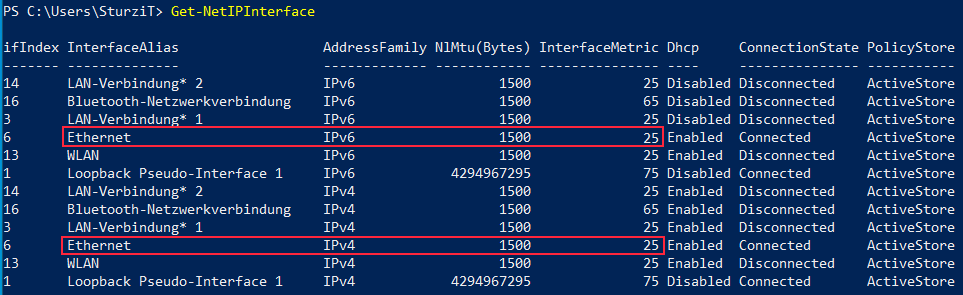

    metrics while VPN is down

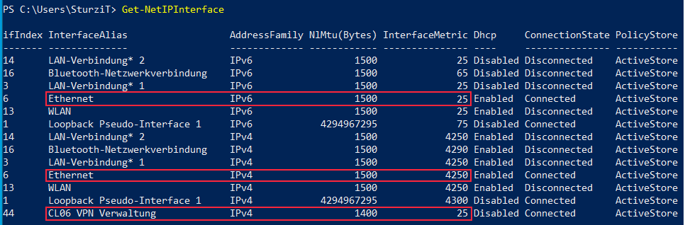

    metrics when VPN is up

    as we can see the metric of the Ethernet interface has changed from 25 to 4250. Therefore VPN CL06 VPN Verwaltung has now the lowest metric and we would expect that DNS responses from the internal DNS servers will be used.
    But we still see the DNS response from the DNS server configured on the Ethernet interface. Because we have to access the internal server the DNS response returns the wrong IP.
