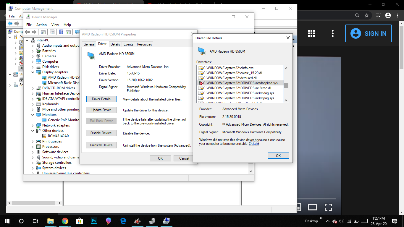

Discus and support amd graphic card is not used but installed in Windows 10 Drivers and Hardware to solve the problem; [ATTACH] there is written windows did noot start drive because it can cause computer unstabe how to fix this the gpu only work in 3D paint app... Discussion in 'Windows 10 Drivers and Hardware' started by DarshanSojitra, Apr 28, 2020.
  1. amd graphic card is not used but installed
    amd graphic card is not used but installed a44ffb05-ea23-4cb3-96d2-089b01d6a3f6?upload=true.png
    the gpu only work in 3D paint app not in photoshop or any other apps
    PLS HELP

    Your computer makes a noise or beeps from your internal speaker because it failed to detect the graphics card. What we can suggest is for you to try cleaning your graphics card with a pencil eraser. Here are the steps below:
    • Turn your computer off.
    • Pull out your video/graphics card.
    • Rubbed the cold contacts with soft pencil eraser.
    • Connect your video/graphics card back to the computer.
    Kindly note that this is just a temporary fix. If the case still continues, I suggest that you contact your graphics card's manufacturer.
    Let us know how it goes.

    Hi Kamal,
    I realize the inconvenience you are facing. Let me help you in resolving the issue.
    The error message you are getting is probably due to some corruption in the Display driver files. I suggest you to try the steps provided in the below methods and check if it helps to resolve the issue.
    We recommend you to download the drivers from the section manually select drivers, from this link :
    http://support.amd.com/en-us/download
    Go to the link under the section Manually select drivers put the graphics card information and select the Windows 10 32 bit or 64 bit .
    Now uninstall the currently installed AMD card drivers an install the downloaded one.
    Method 1 : Uninstall and reinstall the drivers from manufacturers website.
    Sometimes even though the drivers are up to date there might be a some bugs/corruption with the drivers.
    Step 1:
    Steps to uninstall the Graphics Card Drivers.
    1. “Windows Logo” + “X” keys on the keyboard.
    2. Click on “Device Manager” from that list.
    3. Search for the Graphics Card from the device list, right click on it and then select “Uninstall”. On the un-installation window, if you have an option: “Delete the driver software for this device” you may select that and then remove the corrupted drivers
    from the computer.
    4. Follow the on-screen instructions to complete it and then restart the computer if prompted.
    After the restart, please go ahead with the next steps to install the latest drivers and check if that resolves the issue.
    Keep us posted on Windows related queries and we will be happy to assist you further.

    Hello Brian,
    I request you to try the following steps:
    Uninstall and Reinstall the Graphics Card Drivers.
    Step 1: Uninstall the Graphics Card
    Drivers
    • Right click on the Start menu.
    • Click on “Device Manager” from that list.
    • Search for the Graphics Card
      from the computer.
    • Follow the on-screen instructions to complete it and then restart the computer if prompted.
    Step 2: Go to the Computer or Graphics Card
    manufacturer’s website and search for the latest Windows 10 drivers available for the
    Graphics Card model and then install it by following the instructions given in the website.
    I hope this helps you. If you have any further query in future, feel free to contact us. We will be happy to help you.
