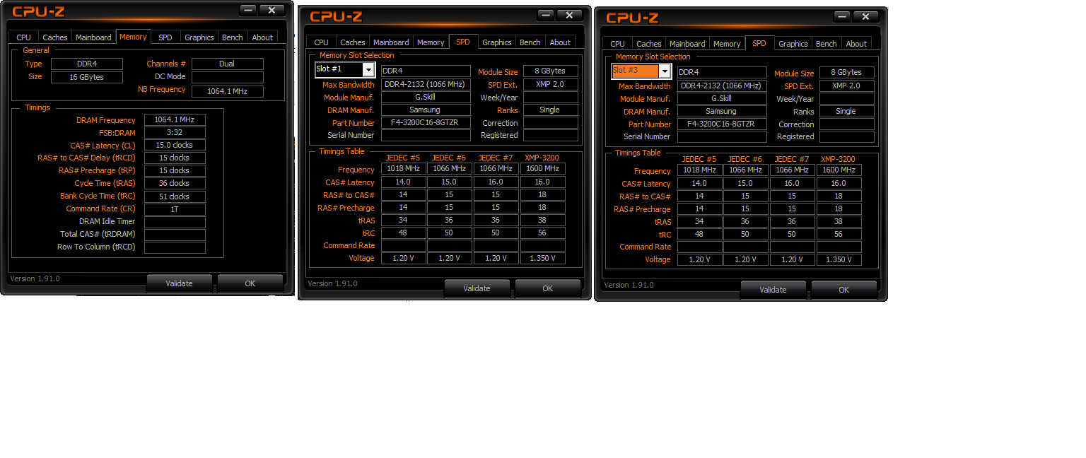

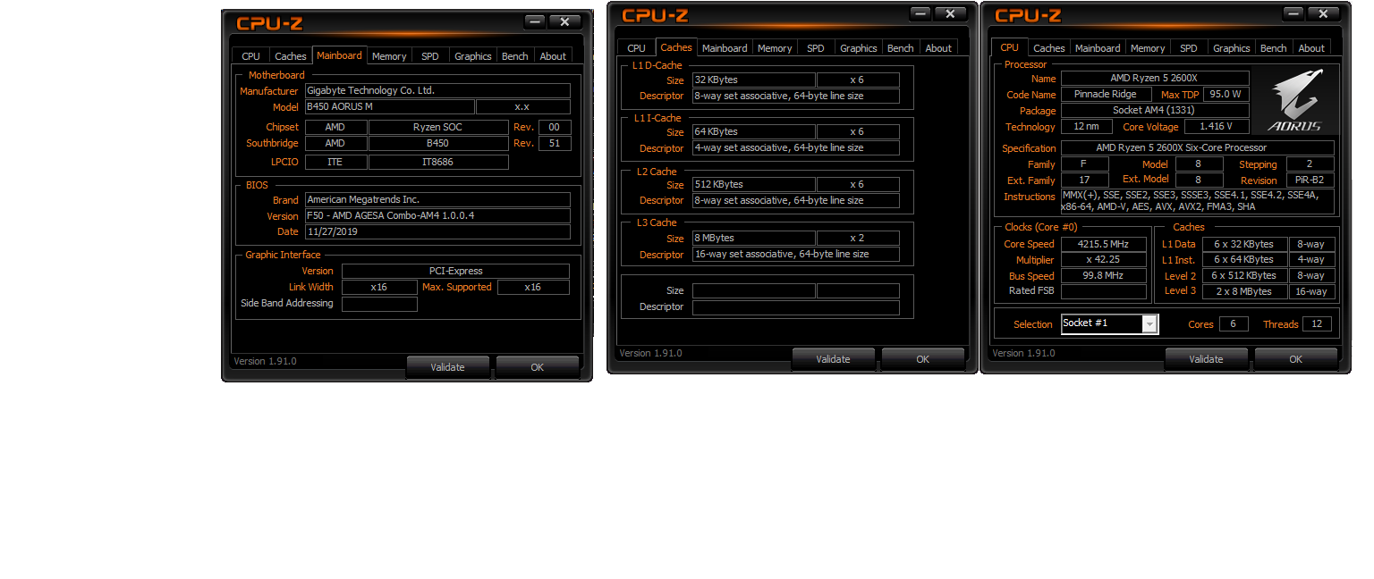

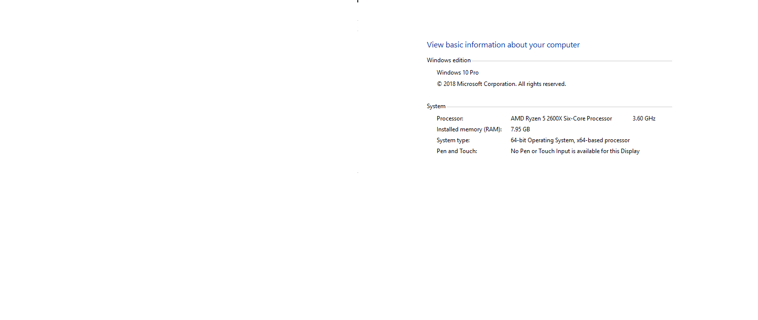

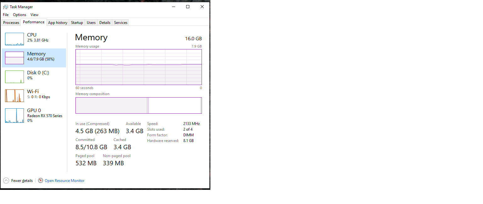

    Hi guys,
    I am having an issue with windows 10 not seeing all of my ram in my computer. The thing is my bios actually sees it. I ran memtest and Memory diagnostic and it showed no issues. my ram is Gskill Tridentz Rgb F4-3200c16D-16gtzr.
    I have also reinstalled windows and did unchecked maximum memory with no change. Its just not seeing it. also My motherboard does not function with just one ram it needs 2 to function.
    Also My motherboard does not come with intergrated graphics.
    Thanks
    Logan
    Aorus B450 M bios seeing 16gb of ram Windows only seeing half. e866f809-8684-4f0f-9856-7be93b31ed57?upload=true.png Aorus B450 M bios seeing 16gb of ram Windows only seeing half. 9f716bc6-d8e6-492e-8407-acbd18b964d7?upload=true.png Aorus B450 M bios seeing 16gb of ram Windows only seeing half. 9bd1428c-4055-4e58-bf50-829f4c418b7c?upload=true.png Aorus B450 M bios seeing 16gb of ram Windows only seeing half. 9e93f5b9-a82f-46ff-b3ce-4582bd60f018?upload=true.png
    Mobi 500x, May 1, 2020

    Take another peek at the pictures he provided in the first post. The BIOS shows each DIMM but on the first BIOS page, it only says the total is 16GB. So even the BIOS is showing all DIMMs but only half the total capacity. I was about to suggest looking at msconfig to see if a max memory cap was there but, that wouldn't explain the 16GB number in the BIOS.
    As far as CPU-Z showing all 32GB, it could be the tool adding up the totals from SPD and not reading how much is available with respect to what's actually usable but, that's only a guess.
    As I said earlier, if there is a DIMM slot that's bad, the OP should be able to run one DIMM in every slot, or at the very least, two DIMMs per channel at once.
    Personally, I would test with the following DIMM slots populated:
    a1, a2, b1, b2, a1 + b1, a1 + a2, b1 + b2
    That will cover every DIMM slot, so assume it's not a physical issue with the board, the machine should boot and detect 8GB for the one DIMM tests, and 16GB for the two DIMM tests in every configuration listed.
    Personally, I have a hunch that only 8GB might show up with DIMMs in A1+A2 or B1+B2, as opposed to running in dual channel as A1+B1.
