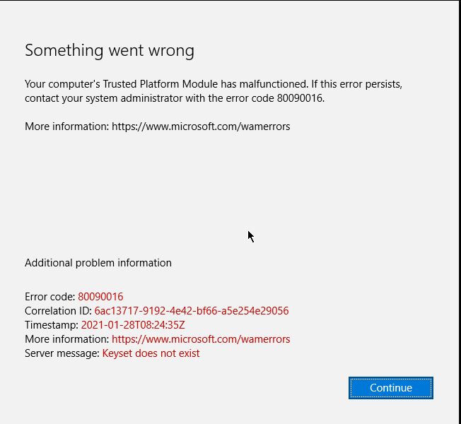

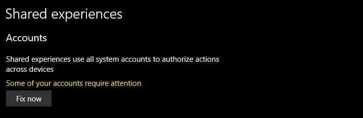

  1. Application credentials are not remembered by Windows after update
    After the windows update I am facing a irritating issue that my credentialsOutlookO365, Skype, MS-SQL server and other several apps are not stored. The worst is being Outlook 2019, every two hours I have to close and repoen the outlook to make it work and each time I have to enter my account password. When I do restart that's it, all the credentials including chrome where I Signed in using my google were wipeed off, I have to enter for all the app I work. Sometimes it says your account require attention in settings.
    I tried few arounds which were floating on the forum but nothing worked out for me.
    Update Version : WIndows 10 Version 20H2 - KB4598242.
    Application credentials are not remembered by Windows after update 75165767-e4c1-47f8-9599-d36cf2112f4a?upload=true.jpg Application credentials are not remembered by Windows after update 05ac3618-5225-4572-9a8e-8f460fbcb7f9?upload=true.jpg
