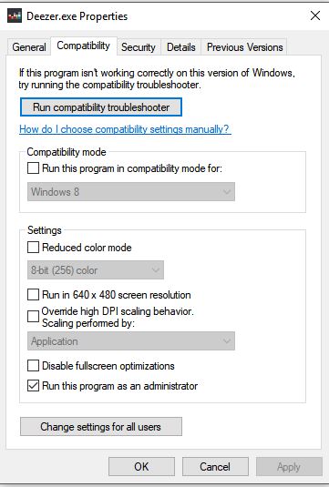

    I had an issue where an app (Deezer) on Windows 10 recently stopped working, and the process in Task Manager showed "Suspended".
    App would just freeze after login.
    I could not get it to un-suspend.
    Simple solution, ran app as Administrator and it was changed to running (after app restart). I updated the app properties to also run as Administrator (always as admin). Properties > Compatibility > Run this program as an Administrator.
    Apps. Suspended in Task Manager af123a58-a324-40b6-b7fa-922935e65b57?upload=true.jpg
    Riaan van Jaarsveld __, May 20, 2019
