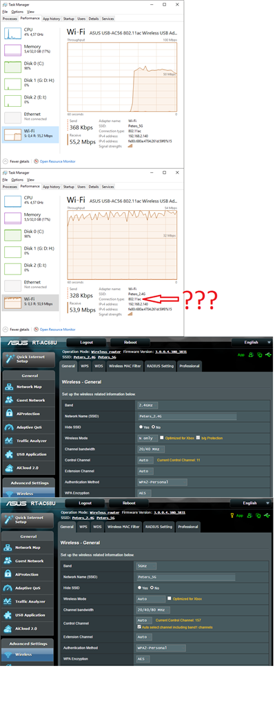

  3. ASUS USB-AC56 adapter and Windows 10
    Also the speed is TERRIBLE and SAME for both 2.4G and 5.0G.
    Distance between RT-AC68U and USB-AC56 is 4 meters.
    USB-AC56 advance setting are default, but I get the same result with the above suggested settings.
    Testing the speed with a USB-SSD drive connected to the RT-AC68U via AiCloud.
    Note that both bands are still in AC-mode of some of reason
    Any suggestions???

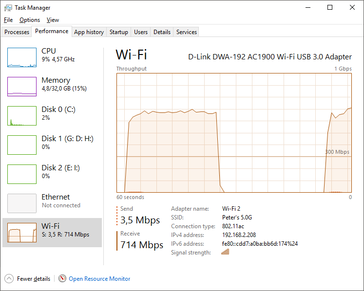

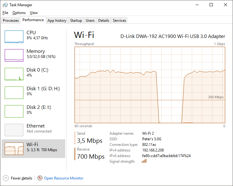

  4. ASUS USB-AC56 Disconnecting every 5 minutes (Quick fix hopefully)
    Finished my tweaking for now. My last post in this thread as I'm done with the Asus USB-AC56, which I couldn't get faster than around 250 Mbps in AC-mode with a third-party firmware, as Asus own firmware did not like the Asus USB-AC56 as I only managed to
    get around 70-90 Mbps out of it.
    Ended up with:
    Router: RT-AC68U
    Firmware: 3.0.0.4.380_4164
    Adapter: D-link DWA-192 adapter
    Driver: 1030.6.1201.2015
    Distance: 4.2 meters in the same room.
    Needless to say, but Asus USB-AC56 sucks and will be sold immediately.... Last time I ever buy an Asus product any more.... Thanks
