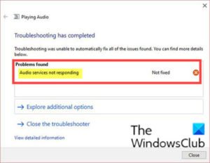

Discus and support Audio services not responding error in Windows 10 in Windows 10 News to solve the problem; [ATTACH]The error Audio services not responding is an error message generated via the Playing Audio Troubleshooter which is usually run when you are... Discussion in 'Windows 10 News' started by WinClub, Jun 18, 2020.

    The audio on my computer isn't working. I've run Troubleshooter and this is what comes up:
    Audio services not responding Not fixed
    One or more audio service isn't running Completed
    Both the Windows audio and Windows Audio End Point Builder services
    must be running or audio to work correctly. At least one of these services isn't
    running.
    Suggestions?
