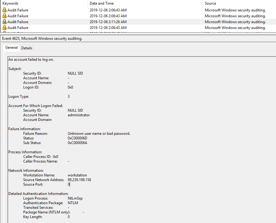

    I am getting a large number of Audit Failures being logged. The entire log view actually
    The Source Network Address varies, but it isn't something that would be related to anything I do. See the one below. Is this a hacking attempt?
    Is this because I have a port open on my router to allow for RDP? Another computer on this (home) network is not experiencing this.
    Audit Failure EventID: 4625 Login 3d2d0839-41bc-490b-91dd-ba0e6e96c813?upload=true.png
    TarasPich, Dec 6, 2019

  3. Event 4625 keeps happening every day at (nearly) the same time
    I understand that you are getting the Event ID 4625 on your PC at a specific time.
    I have been researching on this and found some information which might be helpful for you. You can refer the article
    4625(F): An account failed to log on
    However, as you have mentioned that the Event ID is getting triggered at a particular time there are possibilities that a task is being executed at that time interval. I would suggest you to check the task scheduler and see if any task is executed
    at that time.
    1. Press Windows + S key together and type
      Task Scheduler.
    2. Now on the left hand pane click on Task Scheduler (local).
    3. Now under Task Status select the drop down for
      Last 24 hours/Last hour and check if any task is executing at
      1 PM
    Please get back to us with the detailed information to assist you further.
    We await your response.
    Prakhar Khare
    Prakhar_Khare, Dec 6, 2019
