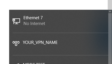

    I was not able to find a way to do this on these forums, but it seems lots of people are asking this question. I started with this thread on Expertsexchange https://www.experts-exchange.com/questions/28808999/Auto-Start-VPN-when-windows-10-starts.html
    I used the task scheduler to trigger a rasdial batch script when Ethernet or Wifi connects.
    Modify this command and make sure it works.
    rasdial.exe "YOUR_VPN_NAME" yourusername password123
    Auto Connect PPTP VPN in Windows 10 95da637e-cb59-4085-96ff-ef6b7d54c469?upload=true.png
    Then modify the script at the end of this post so your username and password etc are correct. Save that script as vpndial.bat somewhere on your computer, some people might drop it right into C:\

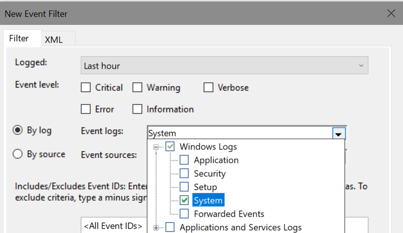

    Open up Task Scheduler, create a new task ( not basic task), name it, go to the Triggers tab, create a new Trigger
    Change "Begin the task:" to "On an Event", change it to Custom, click New Event Filter button, make changes based on this screenshot.
    Auto Connect PPTP VPN in Windows 10 03790f97-3127-47f1-a3af-4293258ac5b3?upload=true.png
    Change the <All Event IDs> field to your two event IDs that correspond to each adapter's network connect. They are comma separated.
    Click OK, then Click OK again.
    Go to the Actions tab, add a new action, Browse to where you saved the script.
    Click OK, then click OK again.
