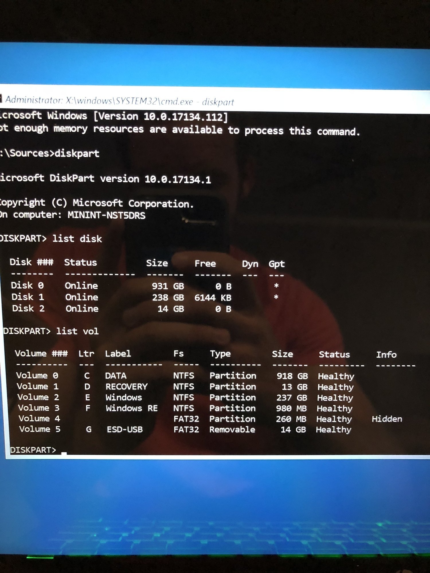

    I have an HP laptop with windows 10 and the other night after restarting my computer it got stuck on the spinning circle then popped up auto repair couldn’t repair your PC.
    The log file is:C:\WINDOWS\System32\Logfiles\Srt\SrtTrail.txt
    After going into the command prompt i discovered another error that looked like this.
    boot critical file c:\efi\microsoft\boot\resources\custom\bootres.dll
    I tried a system restore and no luck. Ive tried the fixboot in the command prompt and get access denied. Ive even tried by booting from a USB drive that was installed from another computer and using the repair computer button and that bring me back to the blue screen with automatic repair however it has a different error that looks like this:
    Log fike E:\WINDOWS\System32\LogFiles\Srt\SrtTrail.txt

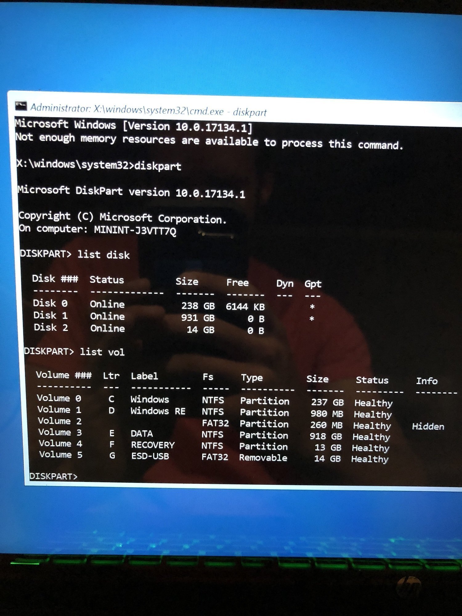

    basically the same error just from a different drive. Im not sure what do and im not certain what drives everything is stored in but this is what my DISKPART looked like after trying to boot from USB. automatic repair couldn’t repair pc e795ddea-a5e3-4820-941f-e391dba8e4aa?upload=true.jpg And then this is what my DISKPART looks like when I boot normally.
    automatic repair couldn’t repair pc 127a6729-73a0-4536-a977-15fe5fb0c8a3?upload=true.jpg Any help would be greatly appreciated!
    Thanks!
