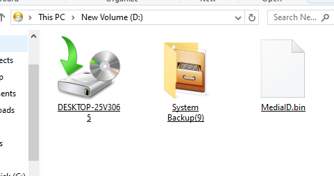

    BACK UP WIN10 FILES OR SYSTEM IMAGE
    Yes i have searched the forums, cant seem to find anyone with my problem..so sorry folks
    I have tried using backup and restore win7 on control panel many times now each time its failed each time i have googles the error problem and followed the instructions...still just now back up failed
    BUT
    I go into external drive and the backup is there inc; the medialD.bin file
    I cant tell if the backup actually failed or it was a sucess
    I certainly dot want to risk a crash and go to use the win10 backup system image file and its useless.
    I have also used AOMEI as a back up in the screen shot
    and that also says right at the end "backup failed"
    I have malaware, win defender, scandisk, checkdisk plus more anti malware and adware progs.
    OK, so it says on the disk drive USB that both back ups are there but are they???

  2. System Image Problem
    I'm getting a head start in case you get on early.
    Can you post camera pics to your thread from your phone?
    There will be steps later that require attention to detail and I'd feel better if I could see what's on your screen. I had to try the steps more than once when I tested the process and I'd like to avoid that on your machine.
    Here's what I'd like to do for the Macrium Rescue steps later on in the process
    I'll post the the step, you'll post an picture of the Macrium screen,
    I'll echo same screen back if I see something that needs changing or I'll just say Go Ahead
    When I confirm that the Macrium screen, you'll make any changes I've highlighted and THEN execute the step
    Here's where you begin today's session, we'll get as far as we get and then pick up when you get back home.
    Step 1: Safeguard the System Image by moving it to a new folder
    1. Connect the Seagate exp drive
    2. File Explorer: Navigate to the Seagate drive
    3. Create a new Folder named 1_sysImage
    4. Move WindowsImageBackup to 1_sysImage
    Step 2: List the VHDs in the System Image
    1. File Explorer: Navigate to 1_sysImage\WindowsImageBackup\machineName\Backup date-time
    2. Press the Type column to sort by Type
    3. Post a screen shot
    Slartybart, Jul 31, 2020
