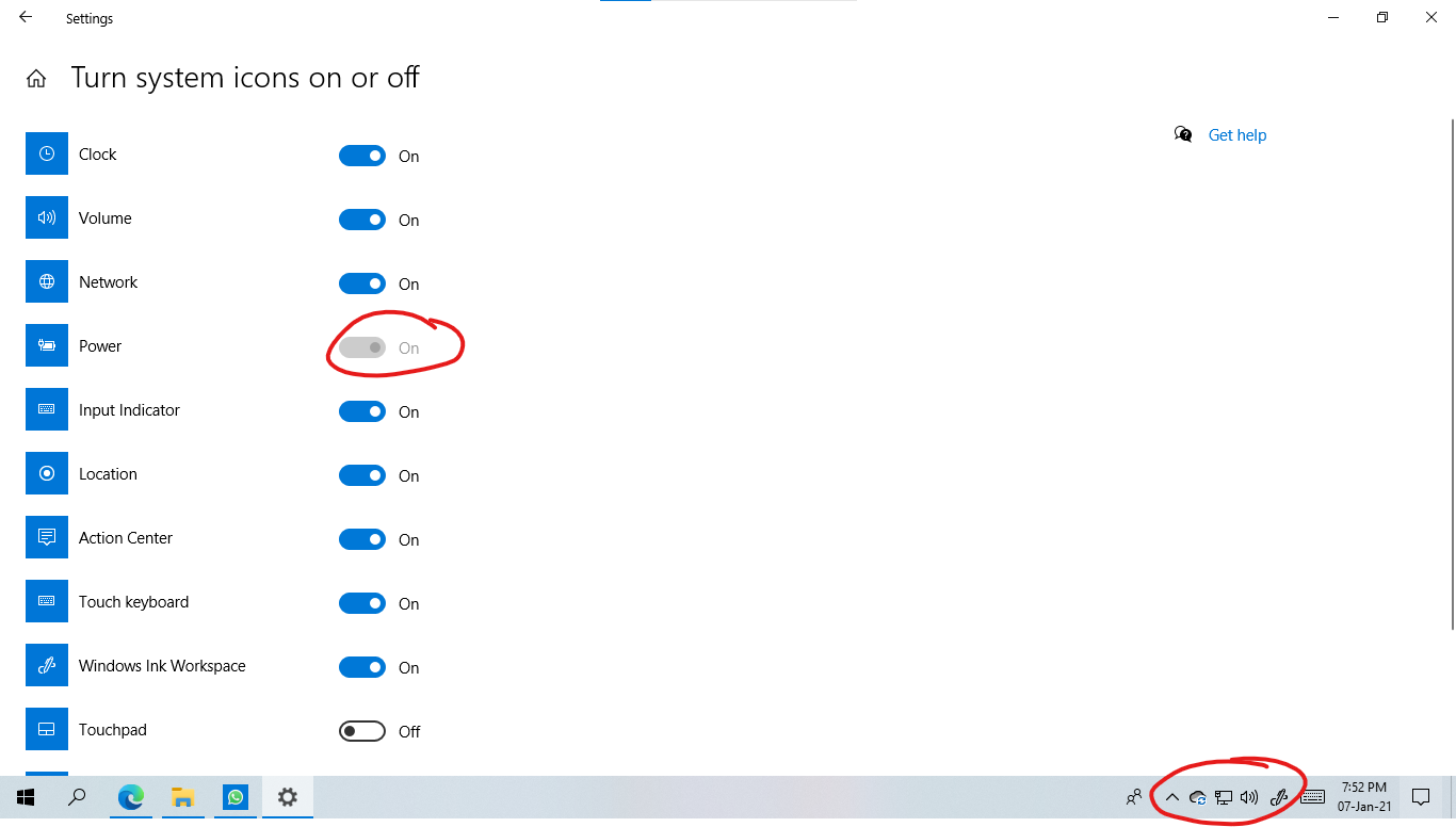

    Hello everyone!
    I have an HP Envy m4 with a 3rd gen i7 and HD Graphics. It has no battery icon in the taskbar, though it's enabled in the settings app. In the settings app, the "power" icon seems to be greyed out, yet in "on" position. Could anyone help me out? Battery icon not seen in taskbar, though enabled in settings problem there too. ad4016ac-c448-4eb5-9e39-9cf8ef496183?upload=true.png
    Praanesh Nair, Jan 7, 2021

    First try and check the following steps:
    1. Right-click in taskbar.
    2. Select Taskbar settings.
    3. Look for the "Turn system icons on or off."
    4. Make sure that the Power is turned ON
    If it is okay and it's still not showing try the following steps:
    1. Right click on start button or simply press windows button and 'x' simultaneously then select device manager and open it.
    2. Then go for battery and expand it.
    3. After expand battery you will get two options one is Microsoft AC Adapter and second one is Microsoft ACPI-Compliant Control Method Battery.
    4. Then right click on Microsoft ACPI-Compliant Control Method Battery means the second one disable it then wait for 5-10 seconds and then enable it.
    -May be your problem got solved if not then show us it again.
