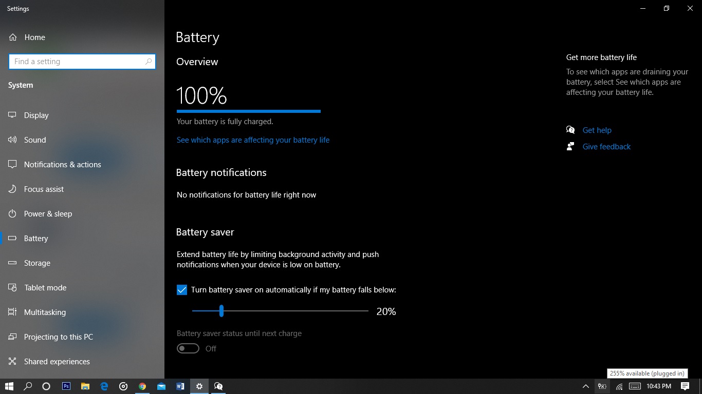

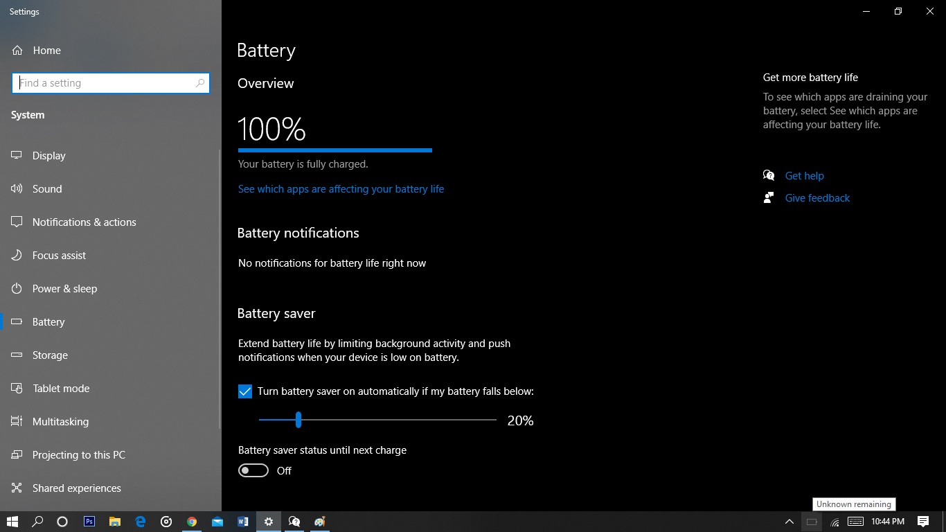

    battery problem 255% fe78e7d0-d56a-498c-bdb4-b6739f634967?upload=true.jpg battery problem 255% 741920e4-7ccc-4675-9acd-2abc2d8d9e9e?upload=true.jpg it shows 255% remaining fully charge but when I plugged it out from the socket it is still full charge but unknown remaining shows on the icon.
    please I need help. I'm having problem with my asus flipbook TP300LD
    JhunCabael, Mar 3, 2020

    As 255% is FF (hex) - all 1's - suggests a certain kind of bug...
    If you have a live boot disk, that should prove it's not hardware related.
    You could also try a 3rd party battery monitoring program, but if that reads the same buggy info from the OS, might give garbage too.
