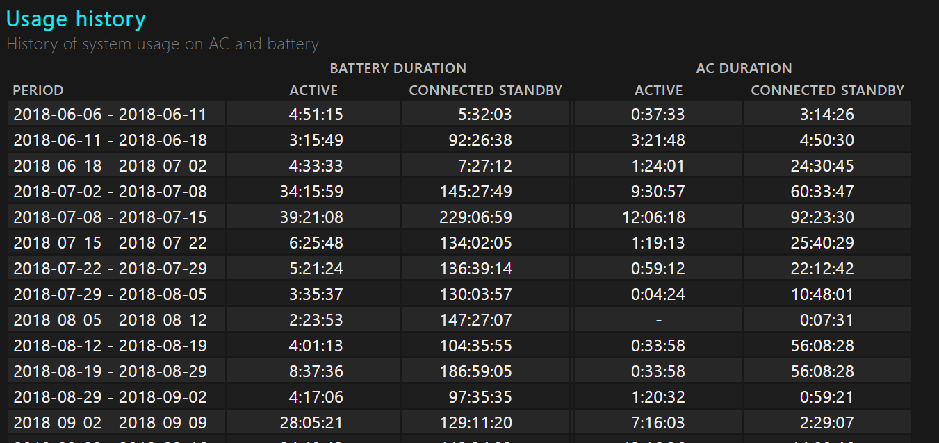

    Hello Folks,
    Lately, I have noticed that the battery on my Lenovo Yoga 920
    laptop has been dying rather quickly while in connected standby.
    Taking a look at the battery report generated by typing "powercfg/batteryreport" in Windows
    PowerShell, I noticed some values in the "Usage History" table that did not make sense.
    For instance, during the 7 day period between 02-10-2019 and 02-17-2019, the battery report states that
    the laptop was in connected standby mode while running on battery for 704 hours, 27 minutes and 54 seconds.
    This is simply impossible, as there is only 168 hours in a 7 day period.

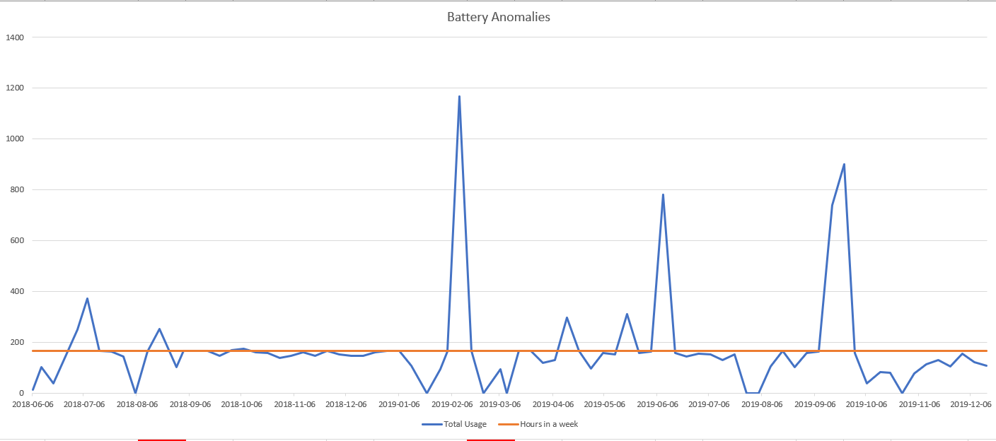

    To look further into the matter, I took the data from the "Usage History" table in the battery report and visualized it
    using Excel. The attached figure shows time on the x-axis and total usage in hours on the y-axis. The total usage
    was calculated as follows: total usage = active battery duration + connected standby battery duration + active AC duration + connected standby AC duration please see column headers in the second figure "Usage History" table to make sense of what I am trying to explain.
    My question is this: given my recent experience of quick battery drains while the laptop is in connected standby, should I be concerned with the spikes seen in the figure? In theory at least, shouldn't we expect the blue curve to be very close to the
    orange line of 168 hours?

    I would like you to know that the battery estimate report is generated as per the sensors that are present within the laptop to sense the battery. It could be an issue with the sensor and that could be the reason you are receiving a false estimate.
    I suggest you to try updating the battery drivers, generate a report and see if that makes any difference. Please follow the steps mentioned in the article
    Update drivers in Windows 10
    and update the
    Microsoft ACPI-Compliant Control Method Battery driver. The ACPI driver is responsible for the power management and Plug and Play (PnP) device enumeration.
    If the issue persists, I suggest you to get in touch with the laptop manufacturer and have a check with the battery and the battery sensor.
