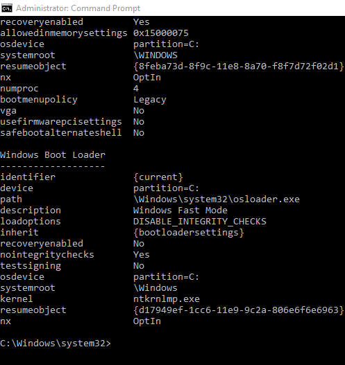

  1. BattlEye- Test signing not supported
    I cant play my video game! Its says that test signing is not supported but when i open bcdedit in cmd it says that test signing is Off/No. What can i do?
    BattlEye- Test signing not supported b3a8e61a-cc14-41d3-b83a-482d38650070?upload=true.png
    BattlEye- Test signing not supported dccc3b77-a242-4c6e-9d66-4a01e929f9fd?upload=true.png
    Lxrd David, Jan 22, 2019

    BattlEye anti-cheat works on first boot of Windows 10 install or update. If you restart after the update it has the 577 error again. What changes from first boot to a restart? Error 577 is usually to do with a file being unsigned, but if you enable test
    signing BattlEye has a different error saying test signing isn't supported because people use that for hacks. I have the most recent insider build of Windows 10 14361 and I just built this PC yesterday. The game works on my old PC with the same version of
