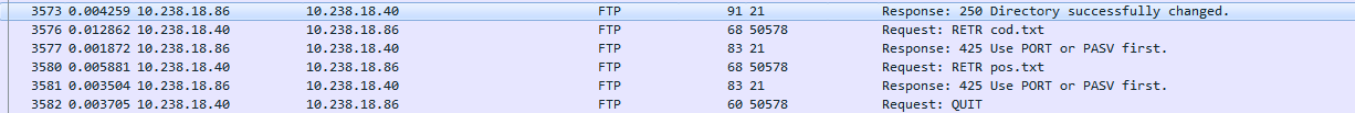

    OPT1: OK
    Winver 1803 - compilation 17134.1069
    ftp version: 10.0.17134.1
    Wireshark capture:
    Behaivour of ftp.exe in Windows10 51e70e5d-7854-4f39-ba19-3dbe366be652?upload=true.png

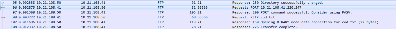

    OPT2: NO OK
    Winver 1909 - compilation 18363.657
    ftp version: 10.0.18362.1
    Wireshark capture:
    Behaivour of ftp.exe in Windows10 4538e755-3965-48cb-8f63-5ed501933a64?upload=true.png
    I dont know why the ftp change to pasive mode in the OPT1 but not in OPT2. Even I try from CMD in the OPT2 the ftp suggest to me change to PASV but after the suggestion it is impossible to chege it.
