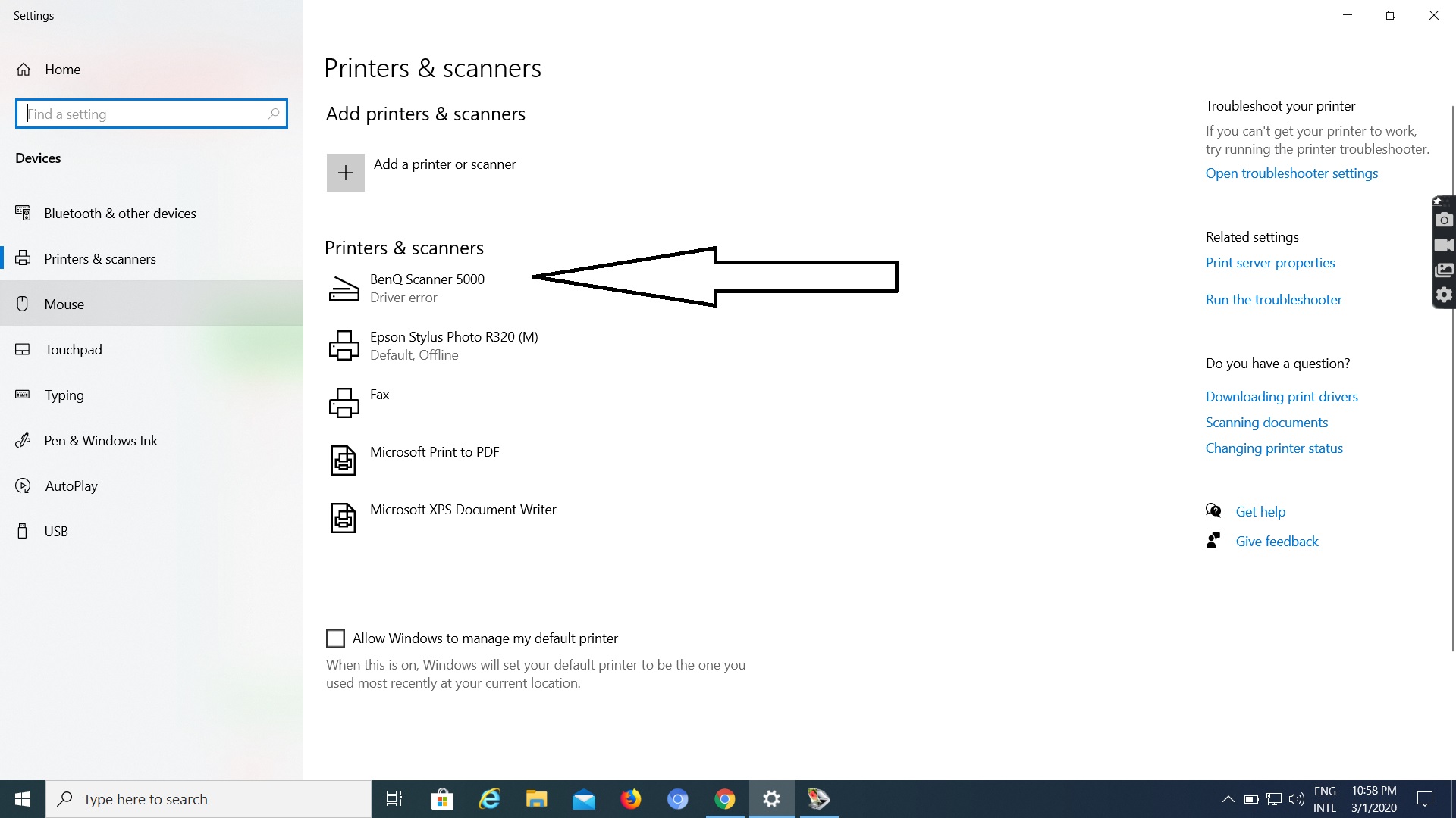

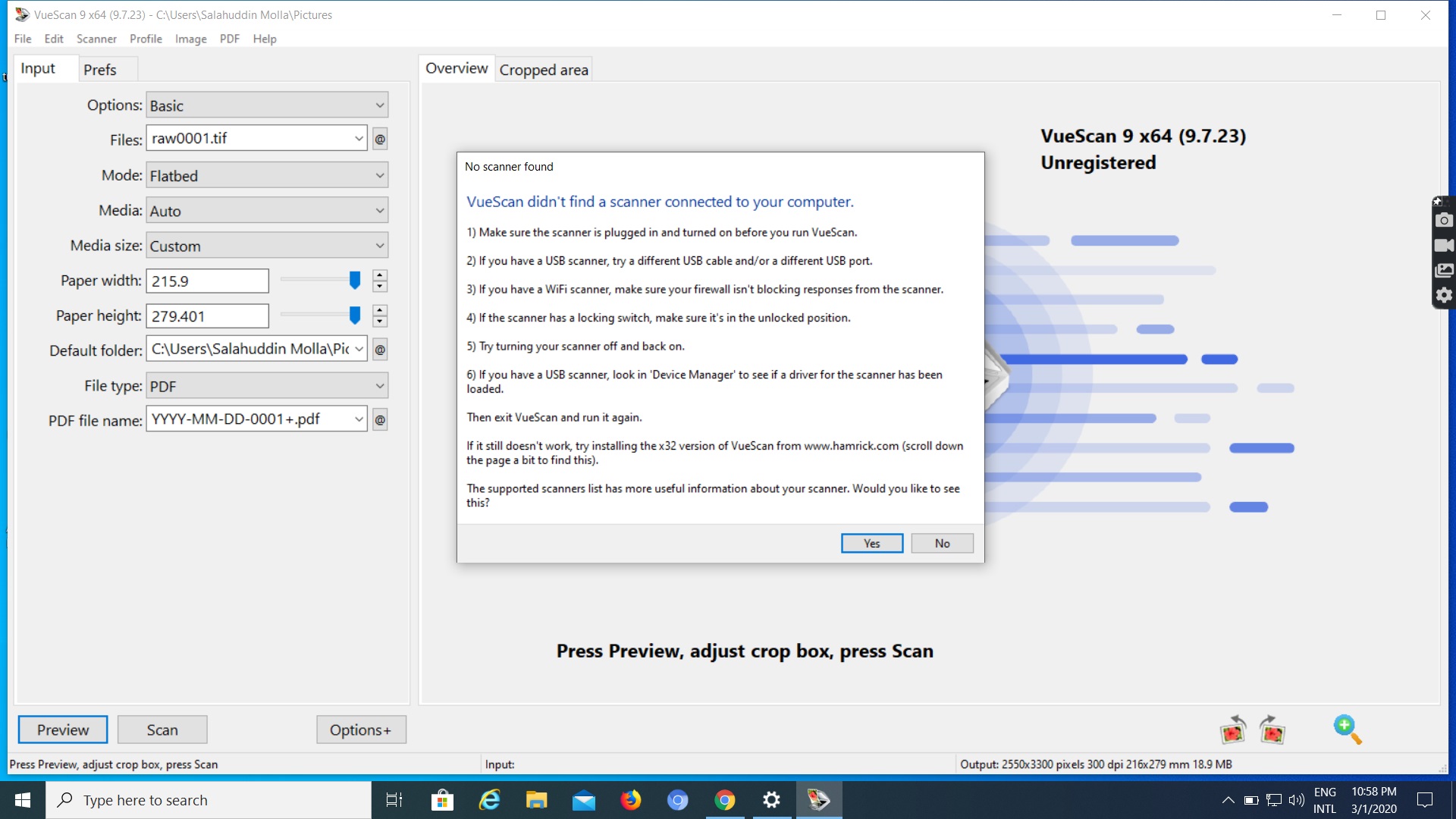

    I have connected my Benq Scanner 5000 to my Dell laptop running Win 10. I don't know why the system says the scanner is not connected. I have also tried with Vue Scan and Vue Scan also says the same issue e.g. The scanner is not found. I have checked the device properties it shows: This device cannot start. Code 10 Insufficient system resources exist to complete the API.
    Please check the attached screenshot and tell me how can I solve this out.
