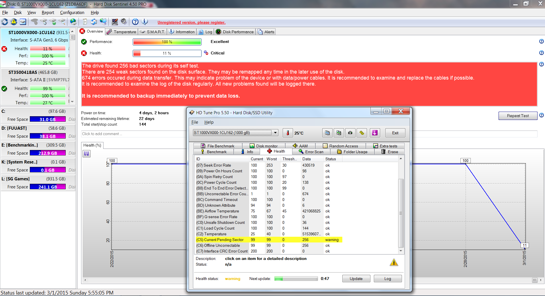

    Seagate 1TB Hard Drive Showing only 11% HEALTH Best hard drive health software? :(
    hey guys,
    i just bought Seagate 1TB hard drive from a Friend few days back. it was working fine. the next day i transfer all of my data from other drives to this new 1TB hdd. today i just saw the hd tune and Hark disk Sentinel both showing low health.
    as far as speed and noise is concern its absolutely perfect on these. getting 140+ avg speed and zero noise level.
    here is the health screenshot
    One thing i also might add, i am facing CRC error frequently, have to Force start during checking phase, while torrent downloading into this Hard drive.
    Can it be a Software bug??
    i need your suggestions and help. please tell me what to do.
    The N, Mar 11, 2021
