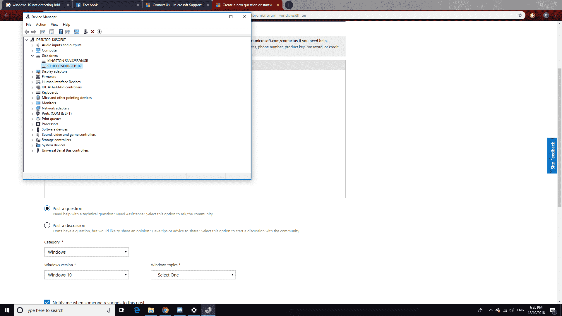

    Hi everyone,
    So long story short, copped a corrupted filed and needed to reset my computer.
    After spending 3 days on the phone to Windows support, we finally got it to work,
    having wiped both the hard drives.
    Everything seems like it is working, but when I went to download and install my apps
    and such, Windows 10 won't detect my HDD. It is detected in my bios, and in device
    manager but not in "This PC" in File Explorer.
    BIOS and Device Manager Detecting 2nd HDD, but not in Files e3751699-98c7-4ea4-87f0-f4a0bf16146b?upload=true.png
    This is incredibly crippling as my SSD is 60GB as it was only intending to contain my
    OS, with the HDD containing everything else. Please help me.
    DanielJohnson9, Oct 12, 2018
  2. Yaqub K Win User
    After upgrading to Windows 10 - 2nd and 3rd HDDs cannot be seen??????
    What is the make and model of your computer?
    I suggest you to check in BIOS setting whether both the HDD are listed there. You may get in touch with your computer manufacturer or refer to the user manual on how to enter BIOS settings.
    If it is listed in BIOS, you may check whether you are able to see both the HDD in Disk Management. Follow the steps to check:
    Press Windows Key + X.
    Click on Disk Management.
    Please reply us with the required information to assist you further.
    Yaqub K, Oct 12, 2018
