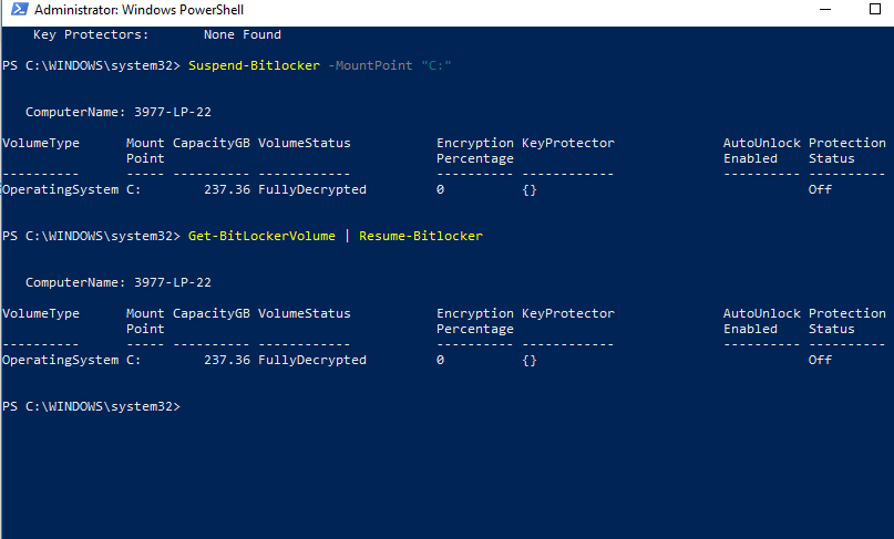

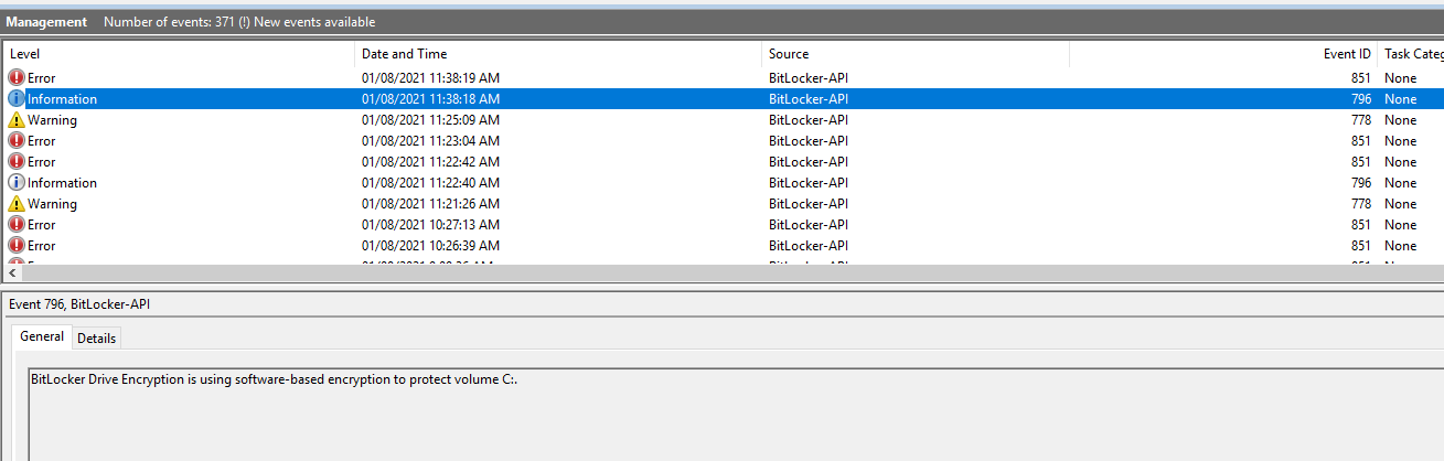

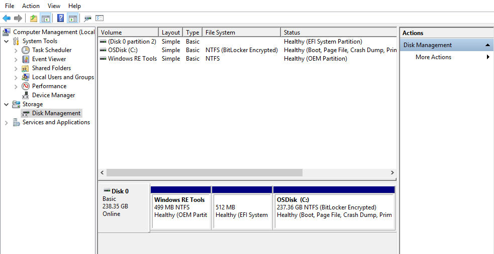

    Hello!
    I have been learning my way around Intune for the purposes of BitLocker'ing our organizations endpoints. Intune has occasionally worked but mostly hasn't. It HAS worked on the laptop I am currently using, but then I would decrypt from the control panel to then try to re-encrypt with a different setting.
    Perhaps its from the repeated encryptions and decryptions, but Intune will not encrypt this machine again. In event viewer message: Event ID:796, Bitlocker Drive Encryption is using software-based encryption to protect volume C:
    But the thing is, encryption is off. Not suspended, but off. manage-bde -status shows it to be off. I even run decrypt scripts on it from sccm and powershell even though it's already off just to double make sure.
    But I noticed in Disk Management, it shows its on even if powershell says its off.
    So I don't know what to do next. Is there a flag somewhere that the disk management is reading that's stuck?
    Thank you, in advance, for any advice.
