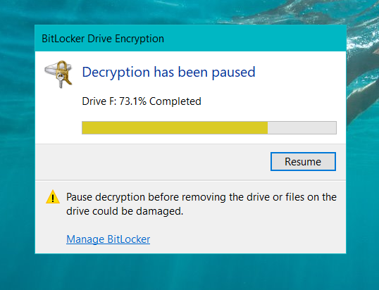

    I plugged in an external HD that was protected by bitlocker.
    A pop-up windows shows that Decryption is paused at 73.1.
    Bitlocker decryption paused at 73.1% and stuck 96b5a84c-3dbb-4edf-b678-555c3eb7c376?upload=true.png
    There is a resume button but when clicked, it only makes it worse and the window is Not Responding.

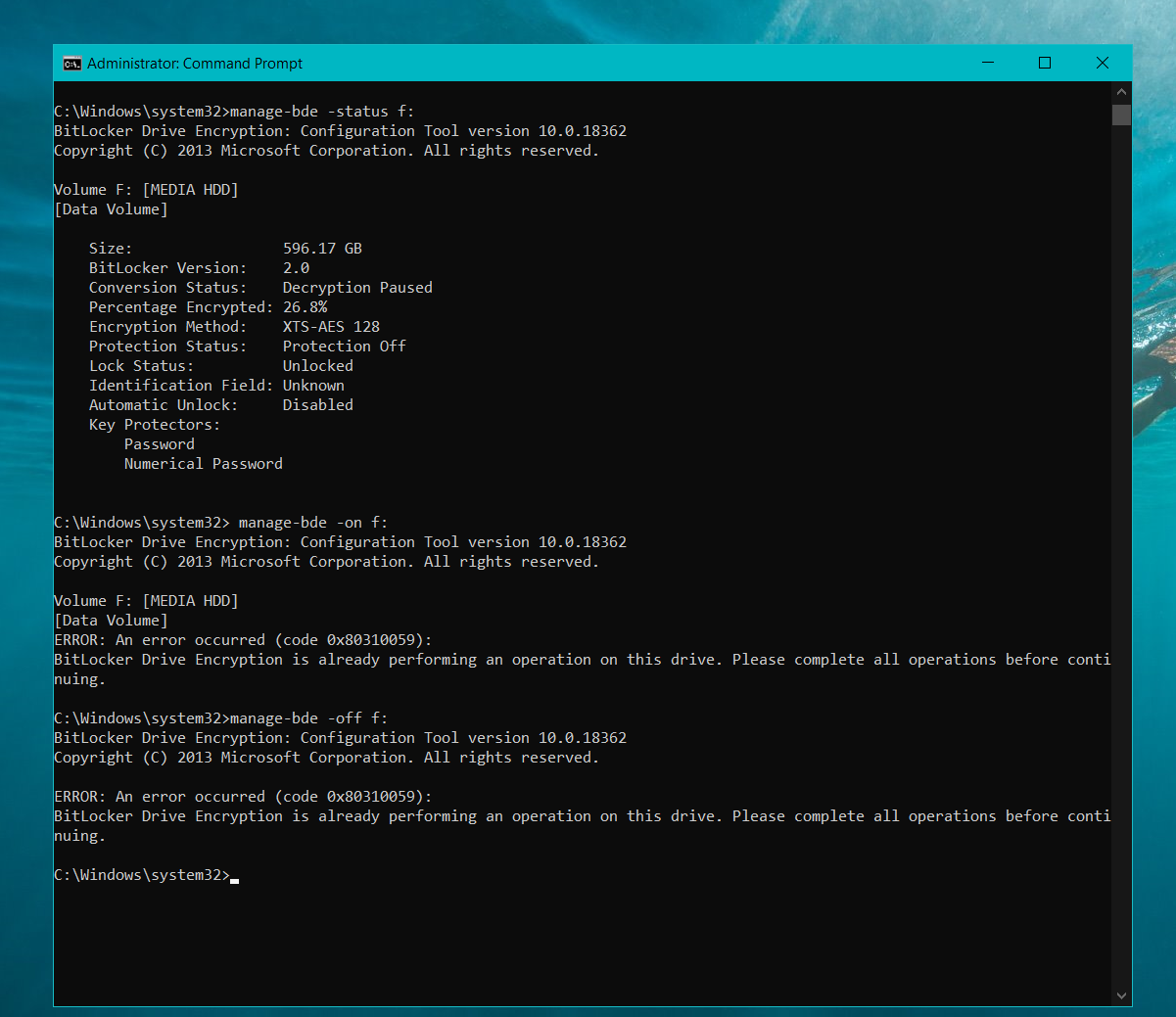

    On cmd, I checked manage-bde -status:
    I tried to do manage-bde -off and -on, but both commands would result in: error code 0x80310059
    Bitlocker decryption paused at 73.1% and stuck 1eb28002-b93c-4b14-88a3-a230b4ec5244?upload=true.png
    I also tried to do on windows powershell the repair and recover prompt, but it doesn't copy any file at all. and the new harddrive does not even make a writing/reading sound.
    I need help. Thanks!

  2. Bitlocker Decryption paused and does not resume.
    Hi Hamza,
    I can imagine the inconvenience you are experiencing and will certainly help you in the right direction in fixing the issue.
    I suggest you to follow the steps mentioned below to fix the issue.
    1. Open the command prompt as admin.
    2. Type in manage-bde –off <drive> and hit
      Enter.
      manage-bde –resume <drive>
    manage-bde –on <drive>
    Replace Drive by drive letter
    1. Restart the computer and check the status of the issue
    You may also refer the article Computer
    Crash: How To Use manage-bde To Recover A Partially Decrypted Hard Drive
    for the detailed information.
