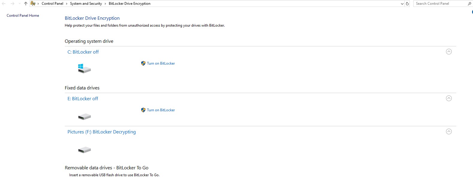

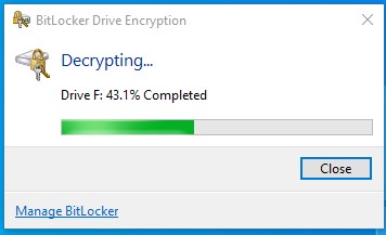

  4. Hamza.zon Win User
    Bitlocker stuck decrypting, unable to pause
    Bitlocker Decryption paused and does not resume.
    i locked one of partition in my laptop with bitlocker. every thing was working fine until i decided to unlock/decrypt it again.
    i did this by following simple steps, and when it started decrypting i unknowingly restarted my laptop, now it is paused and there is no way i can resume it again.
    i can access the partition without any error but the little decrypting window is very annoying, can you please tell me how i resume it or get rid of it?
    some pictures are attached for clarification.
    Bitlocker stuck decrypting, unable to pause acf0a6ec-e2ee-4fbf-843a-da29cb1dc42b?upload=true.jpg
    Bitlocker stuck decrypting, unable to pause be256a44-2ec7-4e28-8499-2e9a74a103eb?upload=true.jpg
    Thanks in Advance!
    Hamza.zon, Mar 20, 2020
