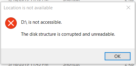

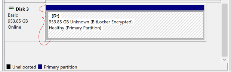

    I'll try to keep this simple, but I'm not a real techy person so please bear with me. I didn't know Bitlocker was installed on my Dell it's a refurbished computer. I installed a SanDisk SSD named D: Drive Hard Drive in January. Needing more space, I removed the hard drive, installed a new SanDisk SSD Hard Drive named E: Drive. Then I moved D: to an external port. When I tried to access it, Bitlocker had engaged and was asking for a password. After HOURS of searching, I found information on checking Azure AD - WOOHOO! Found the 48 digit password. But when I try to access the drive, I'm getting an error that it's corrupt 2nd screenshot. When I go to Control Panel/Computer Management/Storage/ Disk Management, I can see the drive, and that it's got 953 GB used first screenshot and the properties show it's working problem and there are no issues. How is this even possible if it's corrupt and does that mean there's a chance the drive is salvageable?

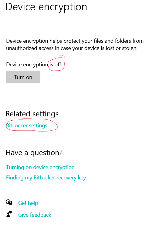

    I've read that Bitlocker has a recovery option, but when I go to Windows/Setting/Control Panel/Update & Security/Device Encryption, it's showing to be turned off 3rd screenshot. When I select Turn On, the hours glass turns, and then it changes to show it's on. However, there are no options for managing or seeing it. When I select "BitLocker Settings", a screen shows up for a second then the whole Control Panels closes. And Bitlocker is not anywhere in my "Apps".

    Screenshot 1:
    Bitlocker was installed on my Windows 10 Home Computer, and now it is gone. Cannot manage... 7684837f-06ca-41d1-a2e8-889fc7b61c47?upload=true.png
    Screenshot 2:
    Bitlocker was installed on my Windows 10 Home Computer, and now it is gone. Cannot manage... 4574056e-a1c2-43ec-bf6c-8ddb7f52a4f9?upload=true.png
    Screenshot 3:
    Bitlocker was installed on my Windows 10 Home Computer, and now it is gone. Cannot manage... ecdb71a1-bb71-4d03-872b-357f179340e8?upload=true.png
