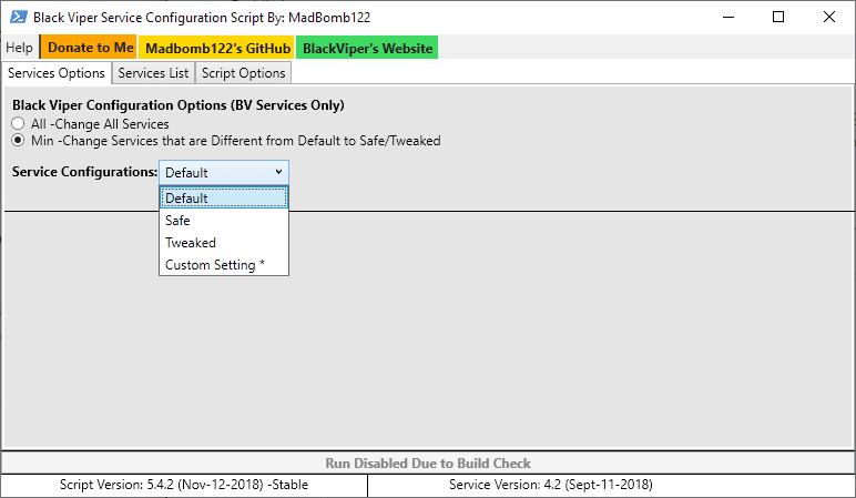

    The script loads a GUI after you accept the terms.
    BlackViperScript: make bulk changes to the Windows 10 Service configuration black-viper-service-configuration.png

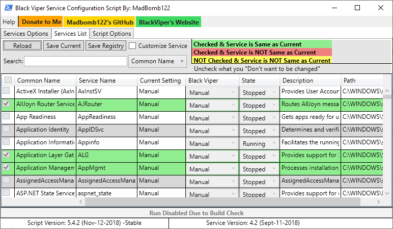

    First thing you may want to do is switch to Script Options to check and adjust the preferences. There you find plenty of options to customize the script; you may check "dryrun" to get a preview of the changes without making them, enable diagnostic output or enable the log to get a before and after comparison.
    The Services List displays all services, information, and the state after you select the load option. The script takes the selected services configuration under "Services Options" and compares it to the current state of available services.
    Green indicates that services use the same configuration state already while red and yellow that this is not the case.
    BlackViperScript: make bulk changes to the Windows 10 Service configuration services-list.png
    The active Services configuration can be saved as a CSV file or Registry file for safekeeping.
    Black Viper Service Configuration Script supports Default, Safe and Tweaked Service configurations and custom settings. You do need to load a custom config file to apply custom settings.
