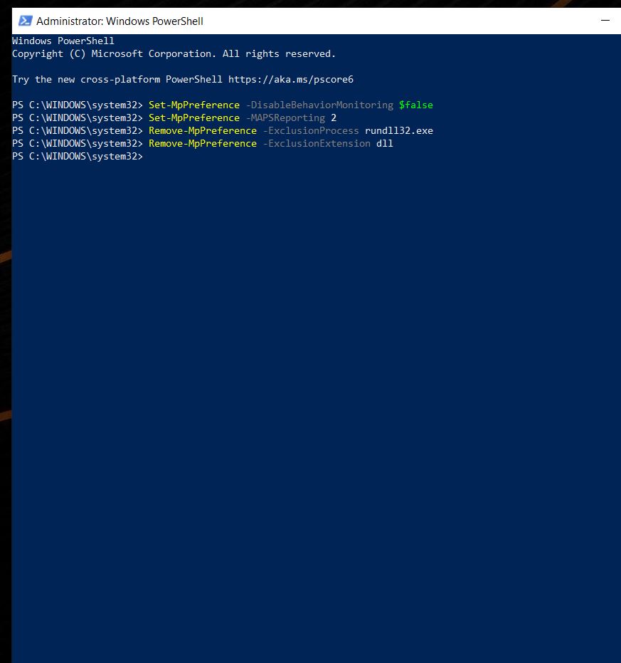

    step 02
    also, i executed the following commands by using PowerShell.exe with admin rights
    Set-MpPreference -DisableBehaviorMonitoring $false
    Set-MpPreference -MAPSReporting 2
    Remove-MpPreference -ExclusionProcess rundll32.exe
    Remove-MpPreference -ExclusionExtension dll

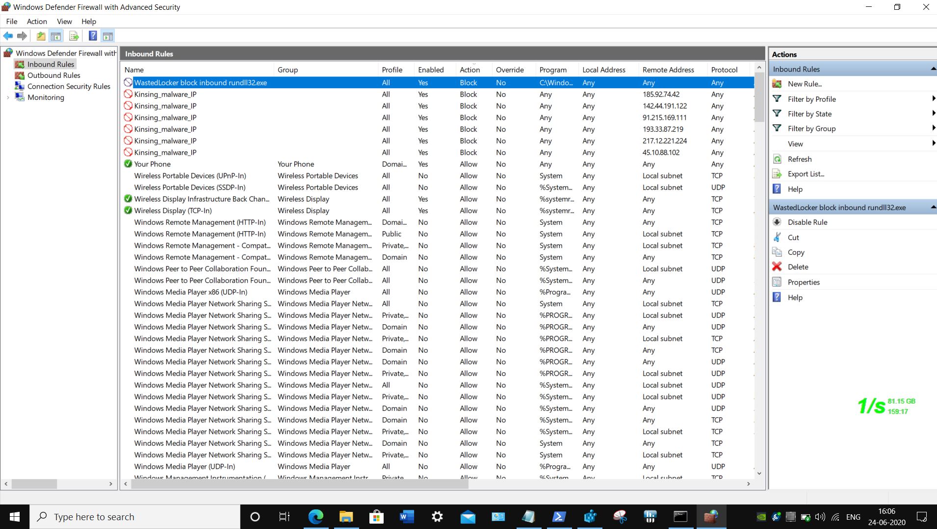

    i blocked program "rundll32.exe" in windows firewall under this locationC:\Windows\system32\ for both inbound , outbound connection with any IP addresses with any protocols.
