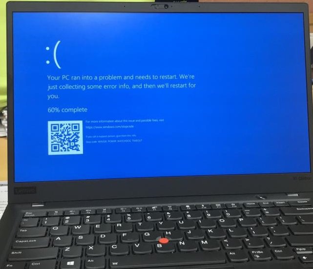

    Hi all
    I have Lenovo with Windows 10 installed. When I lid the screen it goes to the sleeping mode by default, after opening the laptop after this sleeping mode a blue screen with error message appears, the stop code for this error message is "win32k power watchdog timeout"
    I tried power troubleshooting with safe mode but unfortunately did not work. Plz help if u know,, thanks in advance.
    btw this happens when I keep the laptop in sleeping mode for more than 30 minutes
    Blue screen after sleeping mode with stop code "win32k power watchdog timeout" 177aca57-4b30-4143-b9fa-dea18338a179?upload=true.jpg

  4. Blue screen after sleeping mode with stop code "win32k power watchdog timeout"
    win32k power watchdog timeout blue screen
    That is one of the very less documented Bugcheck codes. I suspect it is related to the graphics driver.
    Win32k did not turn the monitor on in a timely manner.
    Completely remove everything using DDU and install the newest copy of the driver available.
    http://www.guru3d.com/files-details/display-dri...
    You can head either to Display driver or the manufacturer of your device to get the newest driver.
    Let us know if you require any assistance.
    Sumit Dhiman2, Nov 11, 2018
