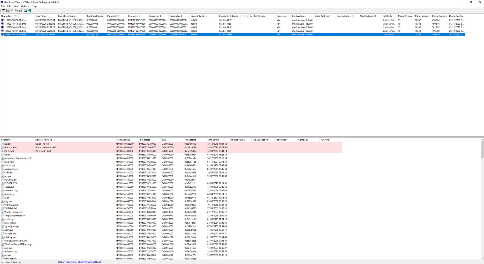

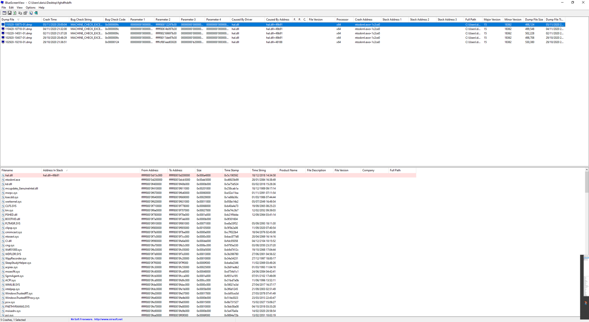

    Hi its my second problem with this issue last was in February 2020 and was solved Previous Issue Now Again form past month I have Blue screens appearing randomly at least once a day . I Had Stress tested CPU in Prime95 to detect any problem and all tests passed same Ram Memory tested In MemTest86 and all pass , even tested and defragmented my Discs and checked for newest Drivers for my components , updated my BIOS and still those Blue screens appears .
    My specs :
    CPU: I5-9600K CPU @ 3.70 GHz
    GPU: Gigabyte RTX 2070 super Gaming Oc
    Motherboard: Asus Rog Strix Z390-E gaming
    RAM : Corsair Venegance LPX DDR4 3200 MHz 2x 8GB
    PSU : Thermal Take Smart SE 730 W
    Im Using two monitors
    OS : Windows 10 Pro
    Antivirus Protection : BitDefender.
    Additional Programs : Kerish Doctor.
    It shows that hal.dll+49b91 mainly its causing it and hal.dll+48188
    and here my Mini Dump files : MINI DUMP FILES
    Thank you in Advance !
    Blue Screen error: MACHINE_CHECK_EXCEPTION 5e937c4f-bff4-48a2-a1d4-44db10f730dc?upload=true.png
    Blue Screen error: MACHINE_CHECK_EXCEPTION 5b641827-cc18-4d59-a73d-57f0c06b93c5?upload=true.png
    Dariusz.dundee, Nov 5, 2020

    I have analyzed the dump files shared by you and found that the issue is caused by the files Intelppm.sys and GenuineIntel.sys. The Intelppm.sys file is a driver file for Intel Power Management and the GenuineIntel.sys is a Processor driver file.
