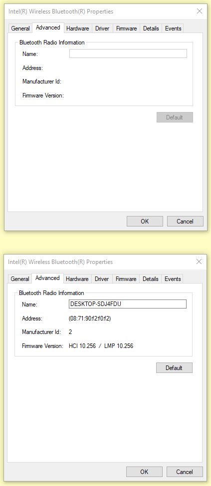

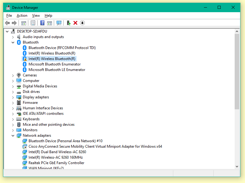

    The Problem in short: my Bluetooth device will not connect at start up no matter what I do. I restart, uninstall and reinstall the driver, I make sure everything is up to date, I put it through trouble shooter, and nothing fixes this problem. I've done everything but look at the hardware it's really the last thing that I want to do
    Something that I find troubling is that when I open device manager it shows me two IntelR Wireless BluetoothR devices. Blue Tooth Connectivity Problems Interesting I promise bb374b9f-a40c-4f39-b4d5-7b68fa665311?upload=true.png

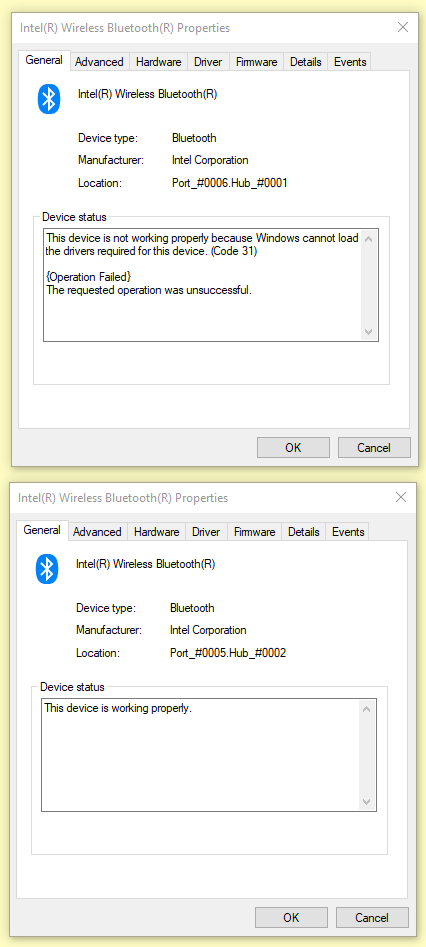

    one is working one is not. When I go into the device to check what went wrong it tells me different codes with no rhyme or reason. Sometimes it gives me Code 31 other times it gives me code 10. I've also noticed that depending on the restart it switches which one fails to load. For example: Below is when I first started my computer tonight
    Blue Tooth Connectivity Problems Interesting I promise e17b75eb-5a28-46b2-a555-5b468efbc3cf?upload=true.png Blue Tooth Connectivity Problems Interesting I promise 9f542ce5-9e37-4907-a2f3-c75147df3a7d?upload=true.png

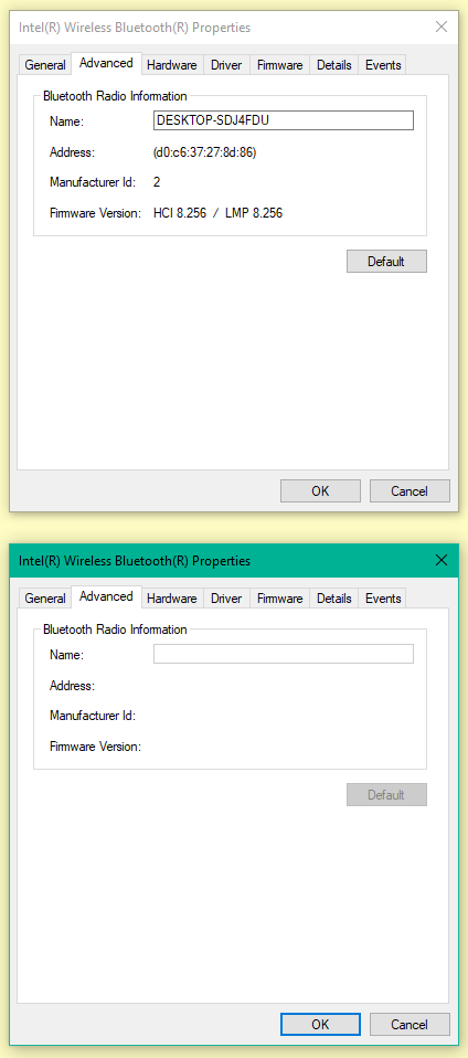

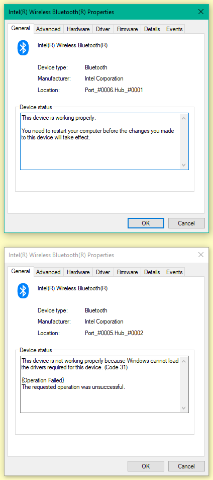

    and this is how it looked once I trouble shot and reinstalled the drivers.
    Blue Tooth Connectivity Problems Interesting I promise 11c96b2c-3b15-4526-99de-f7c9d4f00c48?upload=true.png Blue Tooth Connectivity Problems Interesting I promise 0ea69fc5-5e68-47be-9fa1-0715391e7c40?upload=true.png
    The ports changed which one loaded and which one doesn't. When that happens I noticed that information changes too.
