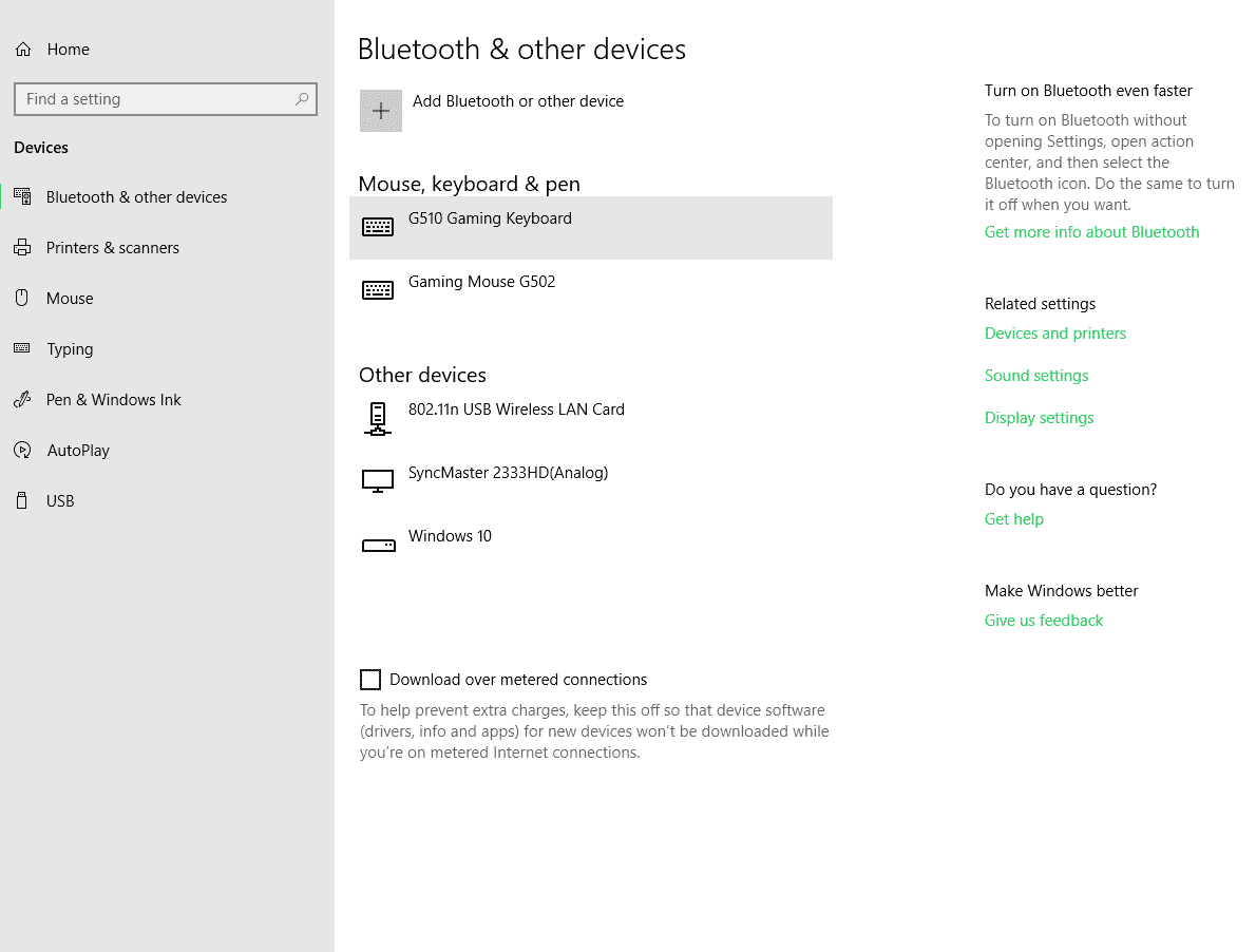

  1. Bluetooth 'Activate/Disable' button not present in settings. Also no bluetooth icon in...
    As read above Bluetooth 'Activate/Disable' button not present in settings, neither is the Bluetooth icon in action centre.
    I'm running windows 10.

    I have no idea why, any help would be appreciated.

    Joe,
    Assuming that you have a Bluetooth card, run these checks -
    Do you have a Bluetooth entry in Settings, Devices?
    Bluetooth 'Activate/Disable' button not present in settings. Also no bluetooth icon in... [​IMG]
    If not then Windows does not think you have a Bluetooth card. Check Device manager for a Bluetooth group.
    1. If neither of these is there then you do not have a Bluetooth card or you have disabled Bluetooth in the BIOS. You should check your BIOS for a relevant entry but BIOSes vary so I cannot suggest where such a setting might be. You could seek advice from your computer maker or their user forum.
    2. If one is there but not the other then you might be able to get it working correctly by reinstalling the driver from your Computer / Bluetooth card maker's website.
    You can customise the items shown in Action center but Bluetooth, if it is enabled, is generally put there by default. As explained above, you can customise what is shown by playing around with Settings, System, Notifications. You can add more entries or you can drag off existing entries or you can drag existing entries around to get them in the layout you prefer.
