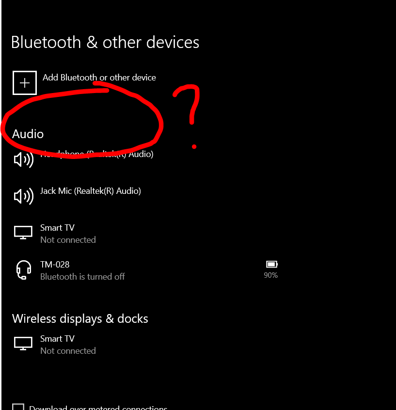

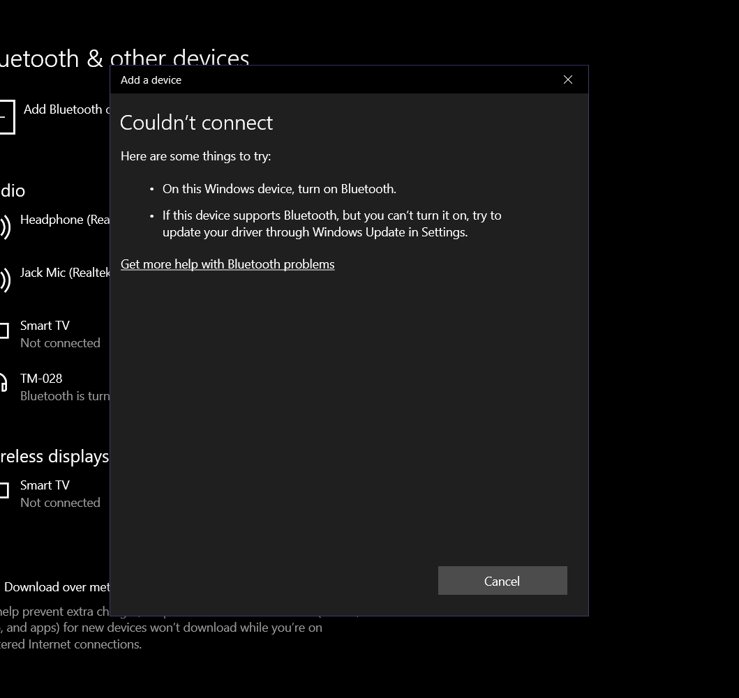

    To whomever this may concern,
    I was just using my buetooth-connected headphones normally until it suddenly stopped connecting. I tried checking but then the bluetooth icon at the action center is gone, so I decided to open my settings. But when I opened settings, the button to turn bluetooth on and off is GONE. Even if I tried adding new device, it only said that my bluetooth is turned off. It also said to update my driver through Windows Update so that's what I tried.

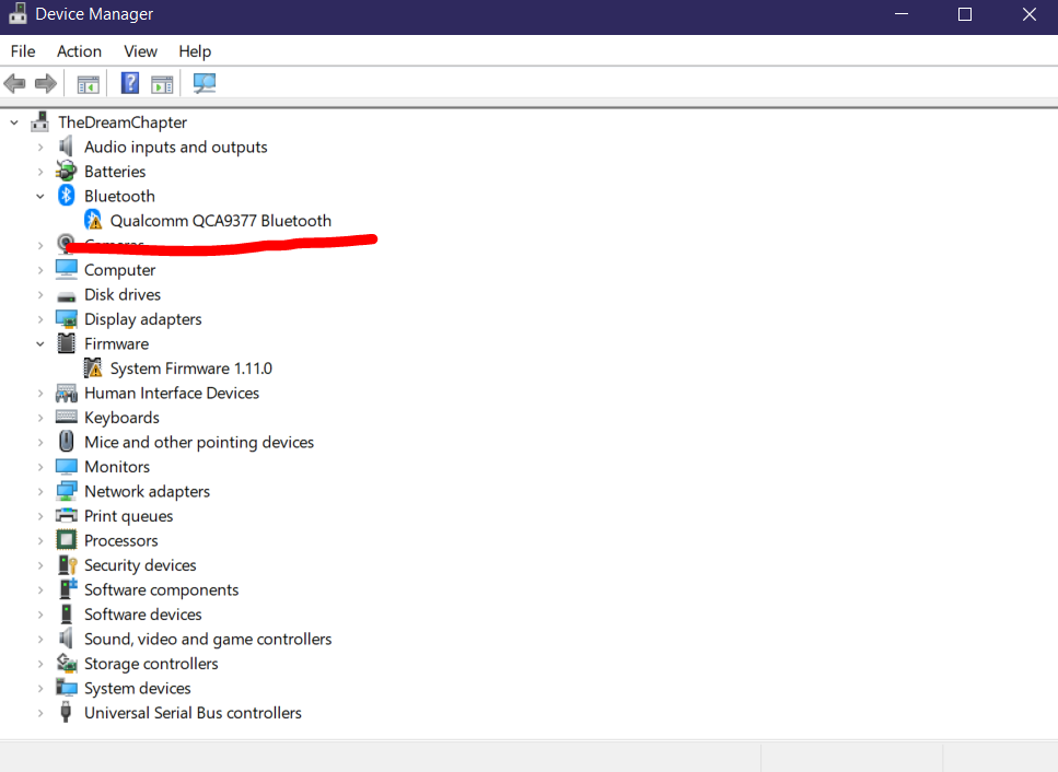

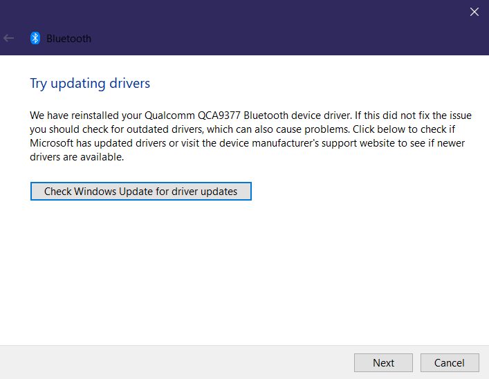

    However, when I checked my Windows optional updates, it said that my driver is already up-to-date. I tried checking at Device Manager but it still says my driver is up-to-date. However, there was a 'problem' symbol under my bluetooth icon pic 3 so I even tried disabling and re-enablin and even restarting countless times but nothing worked.

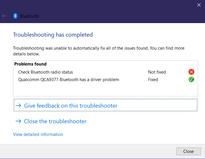

    I also tried troubleshooting for Bluetooth and all it said was pic 4 which my driver is already up-to-date, so I dont understand what am I supposed to do here. When the troubleshooting ended. The only message is pic 5 so my bluetooth is still gone and nothing is fixed. Please help me.
    pic 1
    Bluetooth button and feature disappeared and I can't turn on my Bluetooth bb07a823-e389-44a2-90a1-e5add7c3b6f7?upload=true.png
    pic 2
    Bluetooth button and feature disappeared and I can't turn on my Bluetooth 35abab07-5757-442b-8ae4-b26222055a97?upload=true.png
    pic 3 Bluetooth button and feature disappeared and I can't turn on my Bluetooth f057d26f-b85b-4ae6-86e0-47a526448ad5?upload=true.png
    pic 4
    Bluetooth button and feature disappeared and I can't turn on my Bluetooth 71a4d42a-f8f6-4d01-af5a-648a4a8a418d?upload=true.png
    pic 5
    Bluetooth button and feature disappeared and I can't turn on my Bluetooth a2fd90ca-f715-45de-96f5-6c1efba3ad5f?upload=true.png
