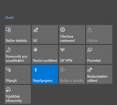

Discus and support Bluetooth button shown and lited up on notification bar, but no bluetooth devices installed... in Windows 10 Drivers and Hardware to solve the problem; Windows 10 latest build, fresh install, still this button shown and blue. I cant disable it anyway and nowhere. [ATTACH]... Discussion in 'Windows 10 Drivers and Hardware' started by Michal Kotek, Jan 20, 2019.
  1. Bluetooth button shown and lited up on notification bar, but no bluetooth devices installed...
    Bluetooth button shown and lited up on notification bar, but no bluetooth devices installed... 52570108-ea5b-4e07-8574-1f09b6866a9b?upload=true.png
    Bluetooth device is shown as not present.
    Hello Dominika,
    Thank you for getting back to us. Since the issue still persists after following the steps on the article above, we'd like to know more. Kindly answer the following questions:
    • Did you checked whether the Bluetooth device is listed under hidden devices in Device manager?
    • What is the make and model of your Bluetooth device?
    • Can you tell us the specific bluetooth devices that you're using on your Windows 10?
    • Have you checked whether the Bluetooth driver is listed under installed programs under Programs and features?
    Meanwhile, we suggest that you check if the Bluetooth services is enabled by following the steps below:
    • Press Windows + R keys on the keyboard, type services.msc and press OK.
    • Right click on Bluetooth Support service and select
      Restart.
    • Right click on Bluetooth support service and select Properties
      and check if the startup type is Automatic.
    We'll be waiting for your response.
