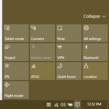

    but in fact it is half off; it has passed control to switch on/off Wi-Fi and Bluetooth to screen taskbar Wi-Fi icon and in the notification bar where various buttons to control various action is shown.
    Bluetooth button/toggle has disappeared?? a49595ac-e576-4cb8-a6b5-6b83d753c476.png
    from there u can switch on/off Bluetooth as well Wi-Fi.
