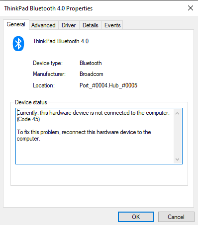

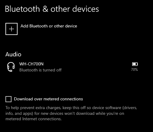

    So my Bluetooth was working fine on my Windows 10 PC Lenovo T430 for the past few months. Then, suddenly, today when I went on Settings to check my Bluetooth, it says Bluetooth is turned off - there is no option to turn Bluetooth off and on, and it has disappeared from Action Center. I tried a few different potential solutions to fix it, none of which have worked:
    1. I used System Restore to bring my Windows 10 system back to a time when the Bluetooth was working. Nothing changed when I went into the new restore point.
    2. I checked on Device Manager to see if something was wrong with the actual Bluetooth devices. The Bluetooth section on Device Manager was hidden, and when I opened it, all of the Bluetooth devices were greyed out. "Scan for hardware changes" did nothing. "Update driver" did not do anything. Under 'Device Status' when I see properties for the device, it says 'Currently, this hardware device is not connected to the computer. Code 45'. I currently have 'Thinkpad Bluetooth 4.0' as a bluetooth device, among others.
    3. I went on Services to check the Bluetooth services and all were running automatically except one called 'Bluetooth User Support service' which would not let me run it automatically. I restarted multiple services and rebooted the laptop. Nothing worked.
    4. I downloaded numerous drivers from Lenovo and tried to connect them with 'Thinkpad Bluetooth 4.0' on device manager. Nothing worked. One driver, when I ran its Setup.exe, said that it did not recognize bluetooth capability in the device.
    5. Ran System File Checker on command prompt - didn't work as well.
    6. I used Windows 10 'Get Help' to diagnose the problem. It discovered the Bluetooth radio in the T430 but claimed that it was missing/in a 'phantom' state - when it tried to fix it, it came up with an error.
    One more piece of info: Before I used System Restore, when my Bluetooth had stopped working, I accidentally uninstalled the 'Thinkpad Bluetooth 4.0' driver on Device Manager. The Events log on the Properties of the Bluetooth device reflects this error.
