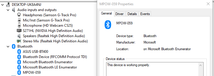

  2. Bluetooth headphones connect but aren't recognized as an audio device
    Maybe I wasn't clear completely, that's on me, apologies.
    The headphones connect and are even recognized by Bluetooth. They are recognized as a device and I can view the details of the headphones through the device manager. The problem is, is that the computer (or Bluetooth? I'm not sure, but this didn't arise
    as a problem until after I reset my computer) isn't recognizing the device as an audio device, therefore I can't check any audio settings through the computer. However, the computer still recognizes the device, so I can manage it's connection
    in the computer. I just can't use them as headphones, since its not registering as specifically an
    audio device.

    If this is an odd problem or takes a while to solve and there are other problems to address, you have no need to waste any time on this. Just a minor inconvenience I thought was odd. Using my bluetooth headphones isn't necessary (since obviously I have plenty
    of audio devices), I have wired headphones that work perfectly fine. Bluetooth Headphones not Recognized as Audio Device. :)
