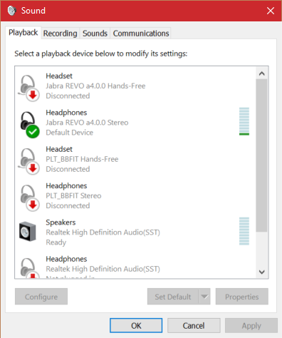

  4. taward Win User
    Bluetooth headset headphones&mic connected, but no audio
    Bluetooth headphones connect but headset portion does not
    All,
    I have a surface pro 4, fully updated. I also have a pair of Revo bluetooth headphones. They also feature blutetooth calling capabilities (i.e. microphone).
    I used to connect these without a problem. Recently something strange has been happening. Now when they connect on the headphones (i.e. stereo audio only) is recognized as an audio device.
    Normally Windows recognizes headsets like this as two separate devices - headphones for audio and headsets for calling. I can confirm that device manager sees them both as functioning normally. But, as shown below, the headset portion is showing as disconnected. But there is no way to connect it.
    Bluetooth headset headphones&mic connected, but no audio 64556d1485963291t-bluetooth-headphones-connect-but-headset-portion-does-not-capture.png
    I have uninstalled and deleted the device and re-paired it. Nothing works. Thoughts?
    taward, Jun 7, 2023
