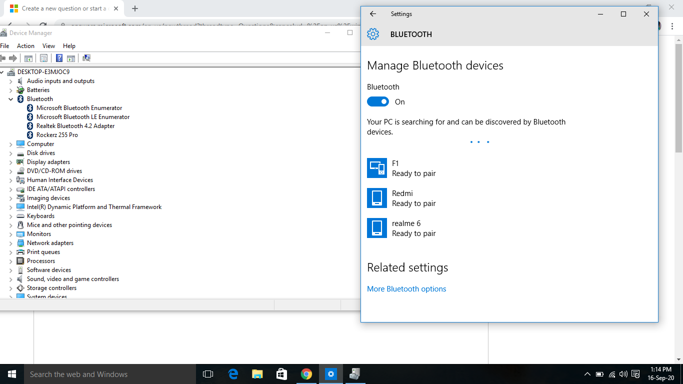

    Whenever i open bluetooth, my bluetooth headset is automatically getting connected but it is not showing in devices. Also if i open bluetooth of my mobile device, then the headset automatically disconnects from my laptop and connected to mobile. As i can see in the device manager, there is a driver of name of my bluetooth device.
    So the main problem is :-
    Since the connected headset is not showing in Connected devices. I'm not able to see the battery percentage of my headset and also it automatically disconnects and get connected to my mobile.
    In the screenshot provided the bluetooth headsetRockerz 255 pro is already connected but not showing in bluetooth devices.
    Bluetooth Headset is connected but not showing in devices in Windows 10 7c2b090a-143c-4273-8bc0-ed0577d5b4ea?upload=true.png
    Ankit Jaishwal, Sep 16, 2020

    This normally happens due to the Bluetooth connectivity issue. I would suggest to try the methods given below and let us know if it works.
    Method 1: Check services.
    • Open the Run dialog box by pressing the
      Windows key and the R key together.
    • Type SERVICES.MSC and hit the Enter key.
    Check each of the following services and ensure that they are in running state. You may also restart the services if they are already running.
    • Bluetooth Support Service
    • Bluetooth Audio Gateway Service
    • Bluetooth Handsfree Service (this service may or may not be available on your computer depending on the Windows 10 version).
    • BluetoothUserService_8c55026
    Method 2: Check if the headset is in disabled state.
    • Right click on the Volume icon (bottom right corner) and select
      Sounds.
    • If the headset is not listed under the playback devices, right click on the empty space of the window and select Show disabled devices which should list the device.
    • Right click on it and select Enable.
    • Again right click on the device name and select Set as default device.
    Method 3: Remove and repair headset.
    • Go to settings->Devices->Bluetooth & other devices.
    • Under Bluetooth, select the device you’re having problems with, select
      Remove device and clickYes.
    • To re-add the device, go to
      Action center, select Connect and then select your device.
    • Follow any more instructions that might appear. Otherwise, you're done and connected.
    Method 4: Update/Reinstall Bluetooth drivers.
    If the above steps does not fix the issue, you may try updating or reinstalling the Bluetooth drivers of your computer. I would suggest you to refer the article on
    Fix Bluetooth problems in Windows 10.
    Kindly refer section '6' to update your system's Bluetooth drivers. You can also refer the subsection
    Audio under Troubleshoot problems with Bluetooth accessories
    and check if it is helpful to you.
    Hope it helps.
    Feel free to contact back in case, you have any questions or need any further assistance with this issue.
    Peer Samie
    Microsoft Community-Moderator
    Peer_Sam, Sep 16, 2020
