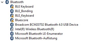

    Bluetooth Low Energy Windows 10
    i have a strange Problem with my Windows PC. The list of my Bluetooth low energy device is growing and i am unable to remove them.
    When i try to remove them in the device Manager, they appear back after a restart.
    On initial bonding the device was asking for a passkey and everything was fine. After a reboot the device was listed in the device Manager with Status_power_failure and i am unable to remove them. And Pairing with this device is impossible.
    Updating the drivers, switching of WLAN and BLuetooth and then remove the devices does not work.
    I tried this with different Bluetooth sticks (CSR, Intel and Broadcom). Every stick has the same behaviour.
    Anyone an idea on how to solve this ?
    best regards
    Lars
    Bluetooth Low Energy, GattCommunicationStatus.AccessDenied b2b23994-2f50-4806-9127-8c8995b32c86.jpg
    LarsHarms, May 8, 2019
