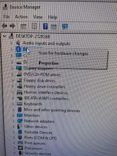

    My bluetooth was working perfectly fine this morning, but upon turning on my computer this afternoon my bluetooth keyboard stopped working. In my settings underneath my keyboard it says "bluetooth turned off" and the bluetooth icon is not in my taskbar or available in device manager. When I click "show hidden devices" in device manager, bluetooth shows up but the only options it gives me are "scan for hardware changes" and "properties" so I cannot uninstall and reinstall.

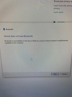

    The troubleshooter does not work as it does not detect that my computer has bluetooth capability but it does!
