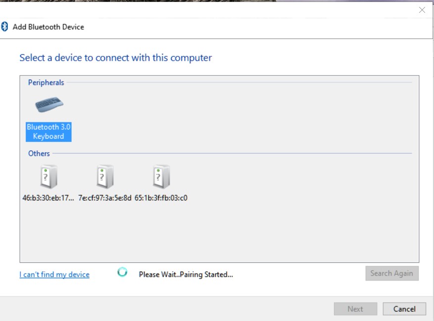

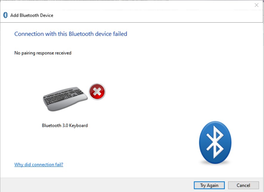

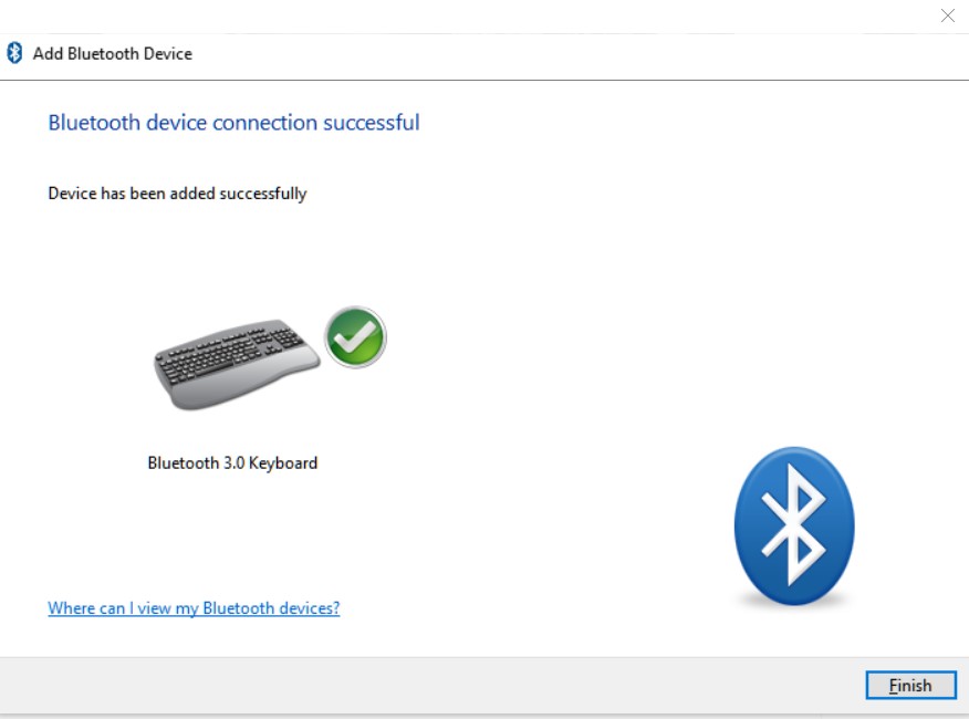

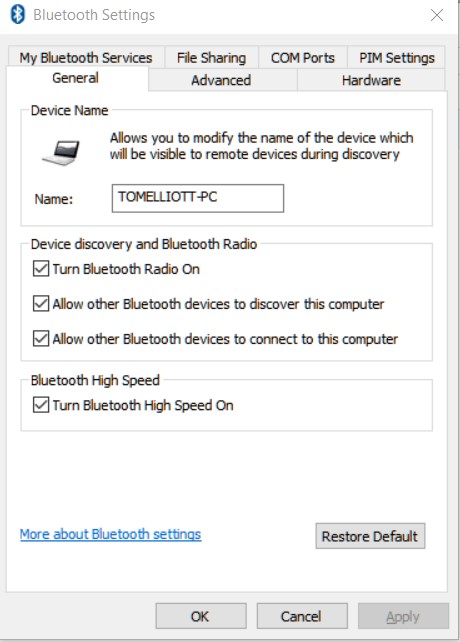

    I have a desktop PC with a bluetooth keyboard and a bluetooth numeric keypad, both of which were working well under W10 1809. Yesterday, I updated to 1903. Now I can't get either one to connect, using my CSR Harmony bluetooth dongle. I get a
    "no pairing response" message after the 30 second timeout. After that, I get a "device has been added successfully" message. But, of course the devices don't work.

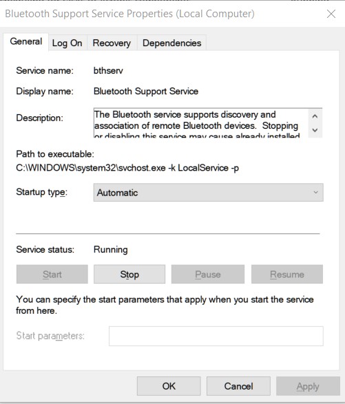

    I checked in services.msc and saw that bluetooth support services is running (startup type: automatic). Could someone please help me with this?
    Much appreciated,
    Tom

    It’s a known bug in ver 1903:
    Unable to discover or connect to Bluetooth devices
    Microsoft has identified compatibility issues with some driver versions for Bluetooth radios made by Realtek and Qualcomm. To safeguard your update experience, we have applied a compatibility hold on devices with affected driver versions for Realtek or Qualcomm
    Bluetooth radios from being offered Windows 10, version 1903 or Windows Server, version 1903 until the driver has been updated.
    Affected platforms:
    Client: Windows 10, version 1903
    Server: Windows Server, version 1903
    Workaround: Check with your device manufacturer (OEM) to see if an updated driver is available and install it.
    For Qualcomm drivers, you will need to install a driver version greater than 10.0.1.11.
    For Realtek drivers, you will need to install a driver version greater than 1.5.1011.0.
    Note Until an updated driver has been installed, we recommend you do not attempt to manually update using the Update now button or the Media Creation Tool.
    Next steps: Microsoft is working with Realtek and Qualcomm to release new drivers for all affected system via Windows Update.
