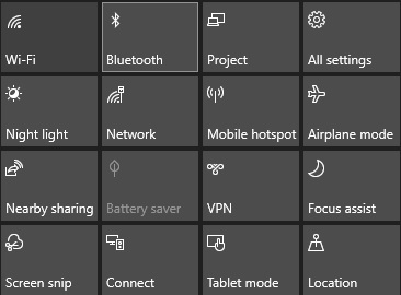

    Bluetooth is shown in the action Center But that button literally does nothing, not disabling nor enabling Bluetooth.
    Bluetooth not working after Updating Windows to version 1903 and 19093 20a37b40-ec8c-46dd-8251-11747e0d4284?upload=true.jpg

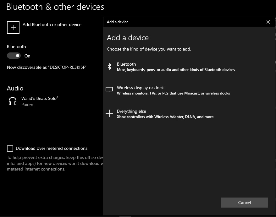

    I can Enable it from Settings,when press add device and select one of these options, the window freezes then disappear
    Bluetooth not working after Updating Windows to version 1903 and 19093 616a43ee-66ff-4ea5-9272-4771e524c12d?upload=true.jpg

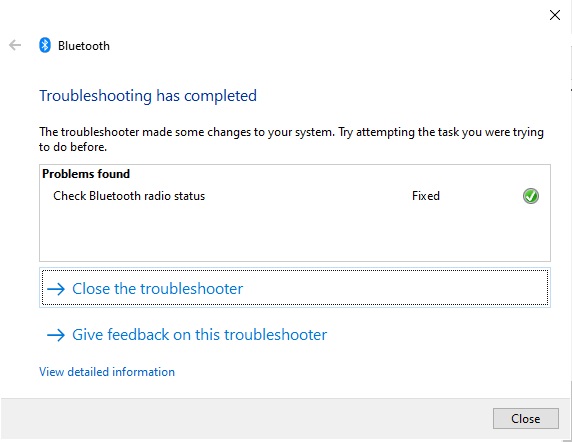

    - Using troubleshooter and each time showing me this:
    Bluetooth not working after Updating Windows to version 1903 and 19093 d2fcc21b-53b5-49fb-ba6d-5e07e3c93044?upload=true.jpg
    But it doesn't change anything and appears each time I try the troubleshooter.

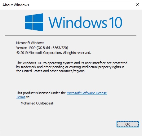

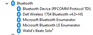

    Some Informations that you might need:
    Bluetooth not working after Updating Windows to version 1903 and 19093 eab3b1f8-b0c4-4c76-8809-1387101c3535?upload=true.jpg
    Bluetooth not working after Updating Windows to version 1903 and 19093 bc6084e2-0a30-408d-b0ee-7d616471b8dc?upload=true.jpg
