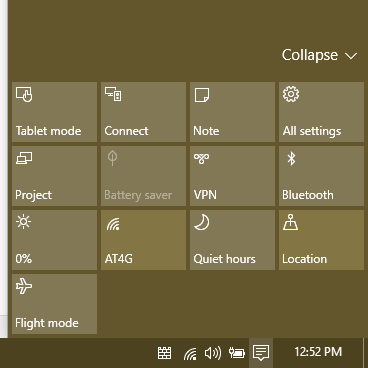

    but in fact it is half off; it has passed control to switch on/off Wi-Fi and Bluetooth to screen taskbar Wi-Fi icon and in the notification bar where various buttons to control various action is shown.
    Bluetooth on off toggle button is missing from taskbar a49595ac-e576-4cb8-a6b5-6b83d753c476.png
    from there u can switch on/off Bluetooth as well Wi-Fi.

  4. Bluetooth on off toggle button is missing from taskbar
    Bluetooth on/off toggle button Windows 10
    I have owned this machine for 2 and 1\2 weeks. As soon as I unboxed and connected it to the web I did the free windows 10 "upgrade" Had I known the issues with Bluetooth on this operating system I would have NEVER done the upgrade. I am using Bluetooth a lot
    for my music. It has been nothing but a P I T A! The unit remains connected on Bluetooth and I cannot use the speakers. I must "remove" the Bluetooth device (my Yamaha V receiver) from the devices connected menu every time I want to get away from my HiFi.
    The on\off toggle would be GREAT for this.....but it does not exist. I did what you suggested and it solved nothing. Again, I am a true "rookie"
    GARYHIPFNER, Aug 24, 2020
