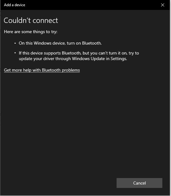

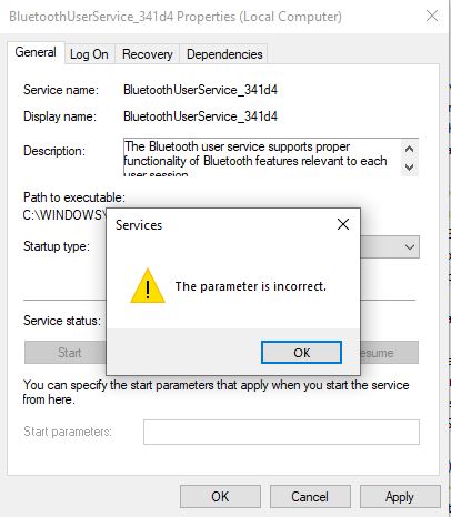

    My Bluetooth service on my Dell Inspiron 15 3000 has stopped working. I cannot connect to any of my Bluetooth devices. I don't even see Bluetooth as an option in the action center. I checked the Services and changed the Bluetooth Audio Gateway Service from startup type from manual to automatic and started the service. I did the same for Bluetooth Support Service. The issue seems to be with the Bluetooth User Service _341d4. It allows me to change it from manual to automatic and change the startup type from manual to automatic but once I click okay, I get the error message displayed below.

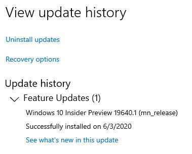

    Everything was working fine prior to my last Windows Update. I have included a screenshot of the latest update installed. What else can I do to try to resolve this issue?

    The parameter is incorrect Bluetooth User Support Service to Auto
    Hi jantis,
    I have found a possible solution for both of us (I can't test it right now) it's changing the start type in the registry from Manual to Automatic.
    Change "Start" from 3 to 2 in the following places:
    Computer\HKEY_LOCAL_MACHINE\SYSTEM\CurrentControlSet\Services\BluetoothUserService
    Computer\HKEY_LOCAL_MACHINE\SYSTEM\CurrentControlSet\Services\BluetoothUserService_33965
    Computer\HKEY_LOCAL_MACHINE\SYSTEM\CurrentControlSet\Services\bthserv
    I am not sure it will work but i'll try it soon
    Edit: I just saw that you cannot turn on/off Bluetooth, i know how to fix that.
    Step 1: Open services.msc
    Step 2: Start the following services:
    and any other Bluetooth related services.
    Then set all of them to automatic.
    BTW: I am having a problem setting Bluetooth User Support Service to Automatic, but the registry thing I showed you up in my post might fix it.
