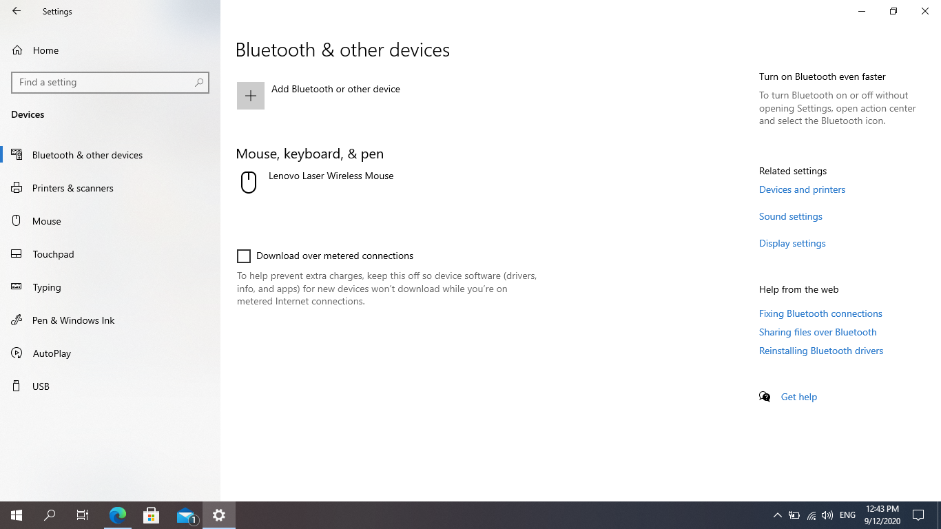

    this is the picture of my Bluetooth settings

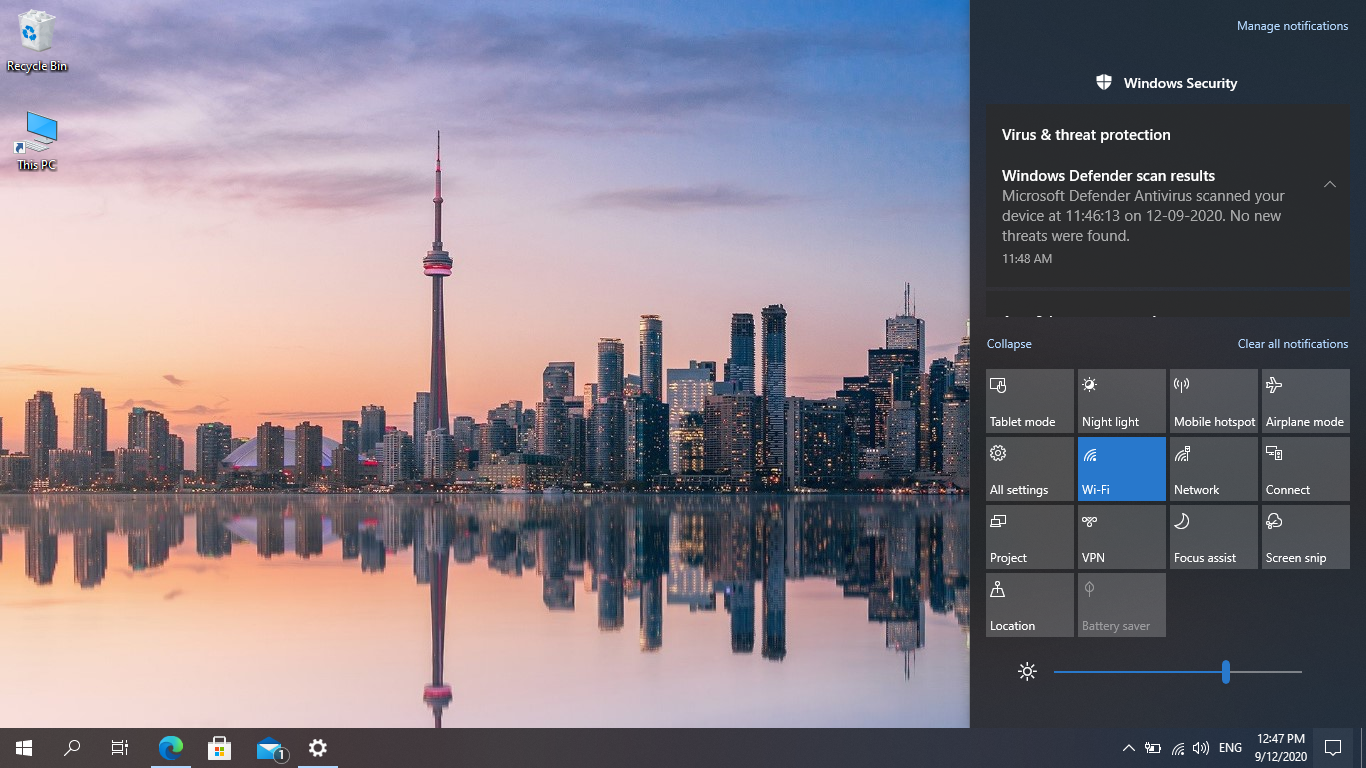

    this the pic of my action center and it is also not showing here. Bluetooth Stopped Working 176a3069-f7b0-4e44-801c-36f179b83108?upload=true.png
