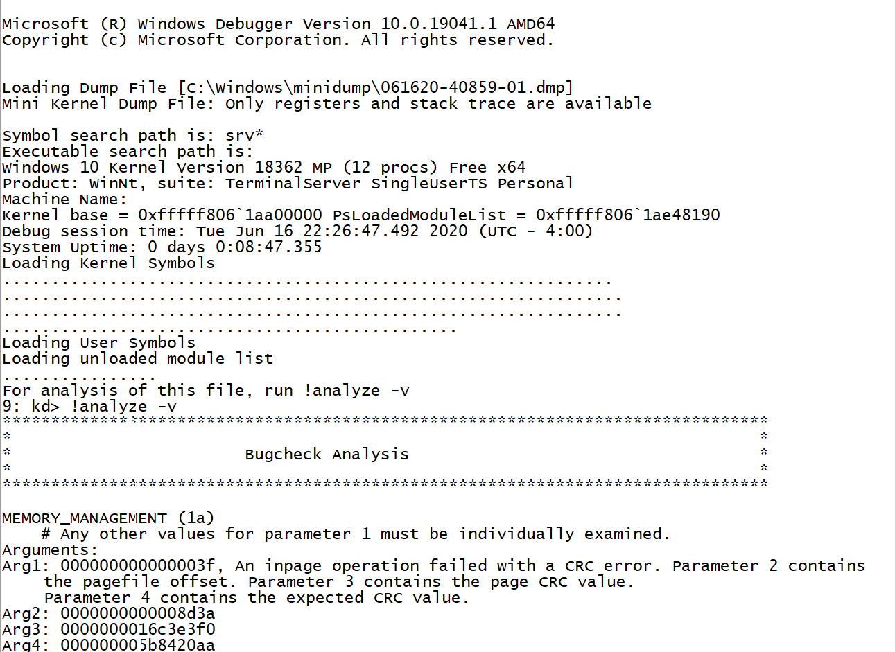

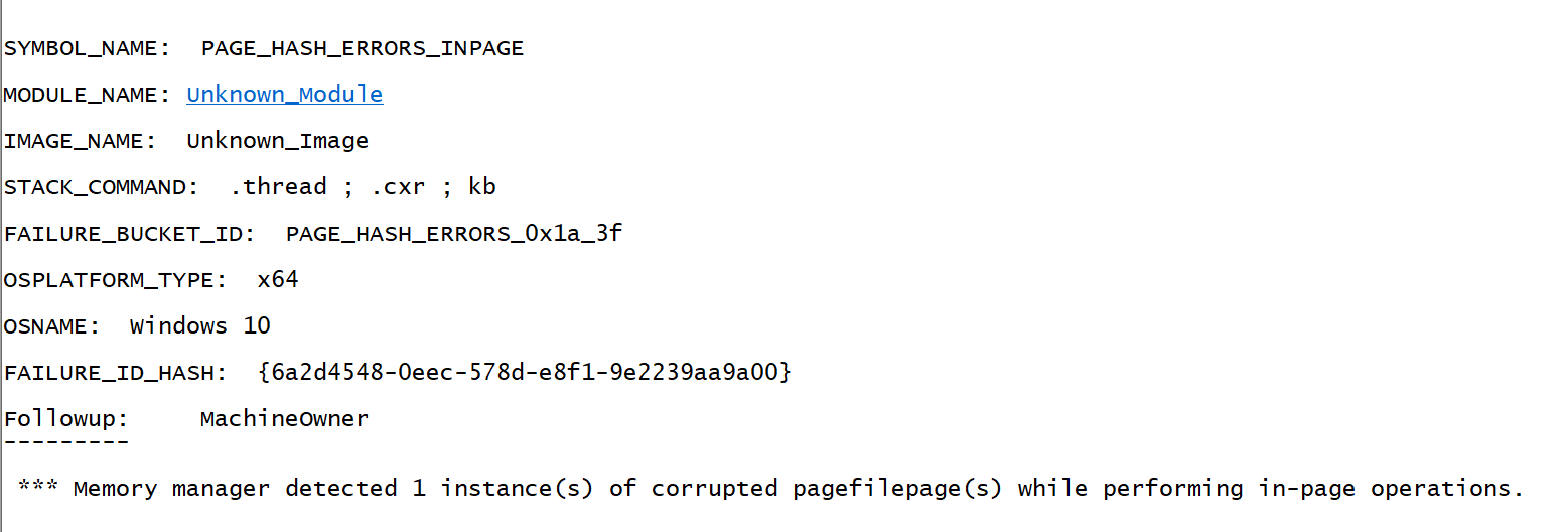

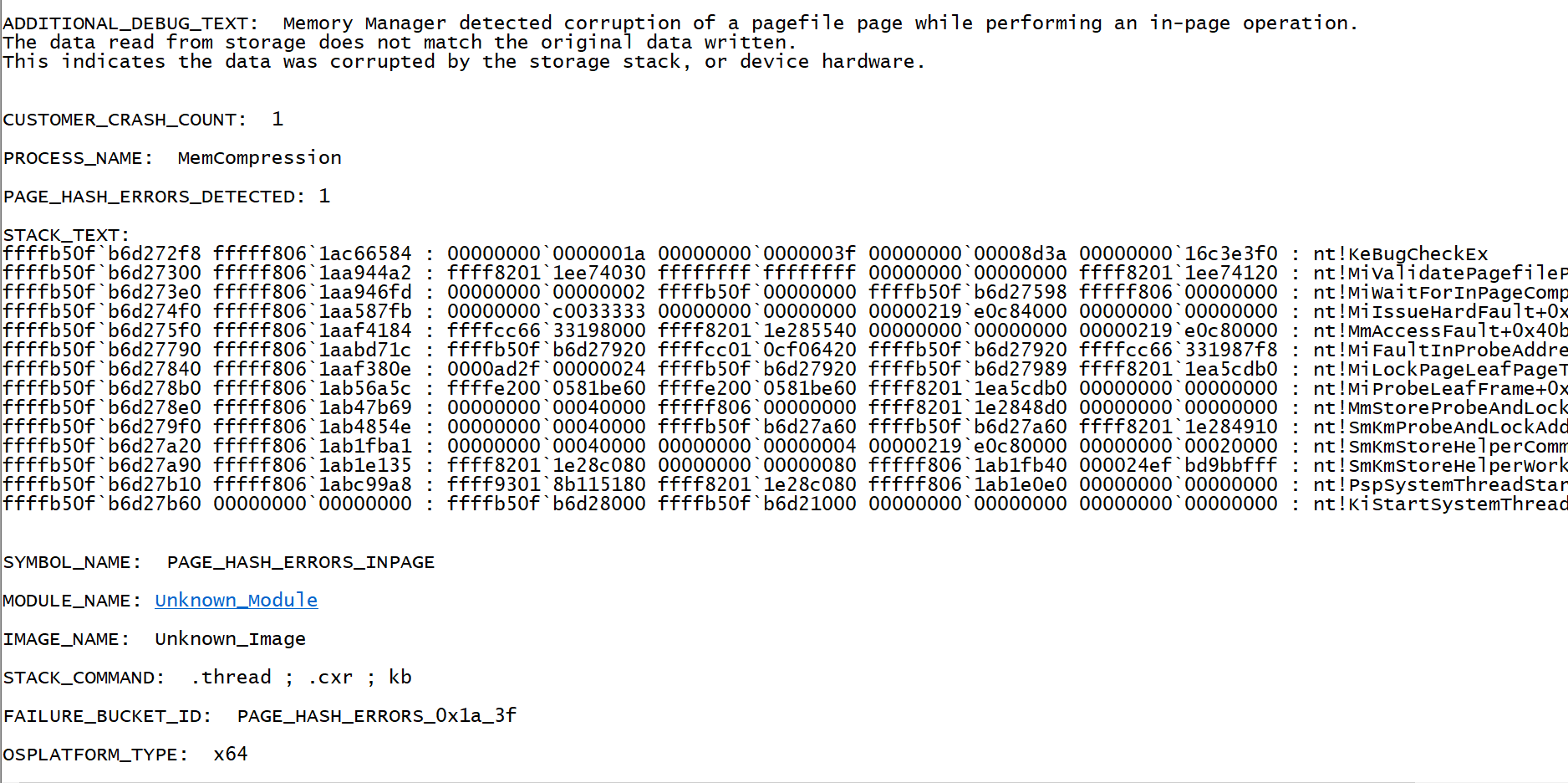

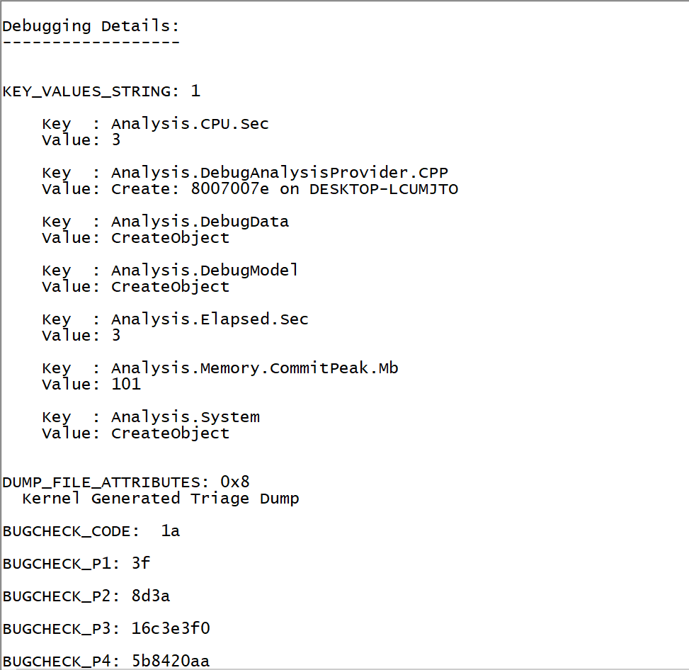

  1. BODS
    My laptop just occur BODS randomly and reboot. The Stop code is: MEMORY_MANAGEMENT And I ran the sfc scan, and memory diagnostic test. But, no problems has been found. Then I open the mini dump, it says" Memory Manager detected corruption of a pagefile page while performing an in-page operation. The data read from storage does not match the original data written. It indicates the data was corrupted by the storage stack, or device hardware. " It may happens, because I installed a SSD three months ago, and these two SSD are not the same so it cause the problems? I don't know how to fix this please help! Thanks. BODS d0e207af-f658-4742-8271-5b2bd17eeb5f?upload=true.png BODS df83240c-2800-4b45-91d4-45a2a3ba3e6d?upload=true.png BODS 2164338e-c39b-47b2-b8fa-725046d9b40a?upload=true.png BODS ee0b63a6-6ce5-47e8-988b-b39d93c3b72c?upload=true.png
    ChunweiChiu1, Jun 17, 2020
